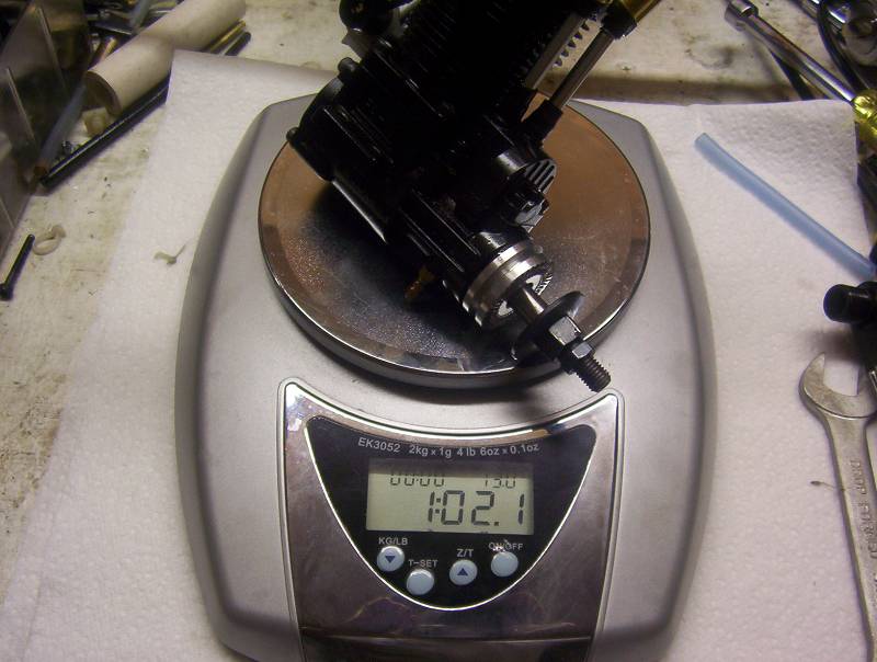

Saito .82/stock muffler, Saito 1.25/TurboHeader and Saito 1.25/stock muffler, all nuts and washers in place plus home made velocity stack on the 1.25.
