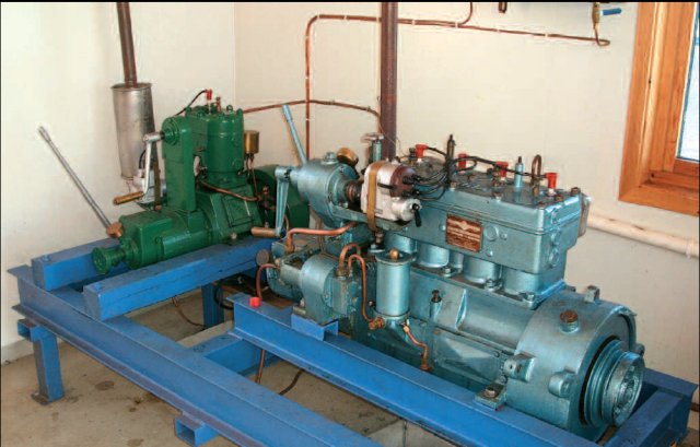

We has same system of the impulse coupler in the magneto mounted at the marine engine, when the engine are handcranked to starting the engine, it is to prevent backfiring and damaging arm/hands since impulse coupler will rotate magneto fast and ignite after TDC, it make easier handstart the marine engine.
Jens Eirik
Jens Eirik
