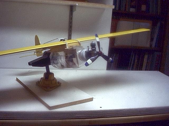

I have three .049 engine and I have such a hard time to start them, they are all the same wen I start them cold, I have to use a needle and put a couple of drop of fuel on the cylinder, I do that a couple of times be-for it starts, some times 10 times. Do any one have a few hints for me on the proper way to start a .049 engine.

Don't know about the engine, but cool SPAD!
