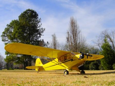

I have a Balsa USA 1/4 scale cub with an underpowered and worn out OS 108. The plane weighs 16.5 pounds. This plane was build on the heavy side. Balsa USA says it should weigh 12 to 14 pounds and a 120 4 stroke is the biggest engine they reccomend. I am thinking about a Saito 150 as I like to have a little extra punch to get me out of trouble if I need it. I will be flying the plane mostly scale. I sure would appreciate some feed back. Saito 125a or Saito 150?

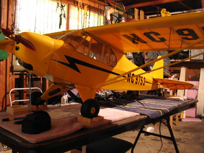

Good lookin' Cub you got there.... If you are dead set on a 4 Stroker, I think the Saito 125 would be perfect. I have a Sig 1/4 Scale full span Cub, that is probably like yours, a little on the heavy side, and I have as OS 120 in mine. The 120 flys the plane with authority, and I rarely hammer the throttle, except when doing loops or inverted flight. I have been hearing great things about Zenoah's little 20c., and you might go that route. If your Cub was like mine, it needed a little weight up front, so a small gasser can help in that area. What is yours covered with, it looks like fabric? Coverite maybe, or solartex....??? Anyway, 'ya gotta love them Cubs, and every one needs at least one Cub in the hanger.

Heres a pic..... maybe......!
