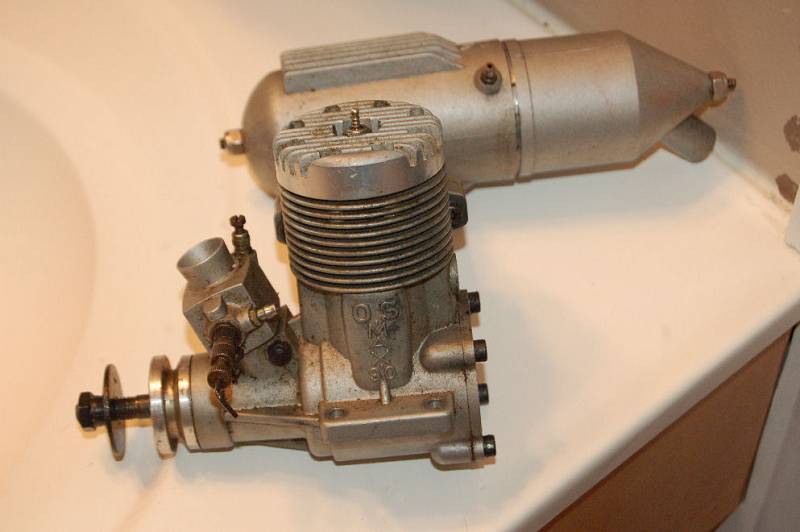

A guy at the club gave me this engine. I can't seem to find any info on it even from the O.S. web site. It's like they never made it.
What I'm really interested in is finding a pitts muffler for it. The spacing of the muffler mounting bolts is 53 mm (2 1/16").
Any info is greatly appreciated.
Kerry

Kerry,
It is an OS.90FSR.
This is a beast, power-wise, compared to current .90-.91 engines, with larger intake bypasses.
The current OS.91FX engine is a bored and stroked OS.61FX, with narrow intake bypasses, which limit its high end power.
This engine is, however, significantly heavier as well.
The strange thing is that the ASP (Sanye China) clone of the OS .91 engine uses a 20 mm diameter crankshaft, like the even larger displacement sibling of your engine, instead of the 17 mm crankshaft of your engine... giving it even more power potential through its much larger crankshaft gas passage.

I have one of these engines as well as the .91 FX. What Dar says is true. The Older FSR is heavier and but produces more power and IMO throttles better.
This is the Pitts Muffler you are looking for. The 1.08 shares the same exhaust.
Regards,
Jeff

I put an APC 14x6 prop on the engine last night. There is NOT enough shaft length to put a spinner backplate on.
Have prop hubs increased in thickness in recent years? Does anybody make 'thin' props? Is there a certain brand that is thinner than others? Is wood thinner?
Help!!!!
Kerry

Check Graupner-G-sonic and also the wooden one of Maro at:
www.lindinger.at
www.der-schweighofer.at
I have the following ones with thickness:
APC 14x6 has 18mm and it is a bit heavy for OS.91 anyway,
Graupner-G-Sonic 13x7 has 12.5mm
Maro 13x7 has 13.5mm.

Both versions of the old 90/91FSR had the same crank with a short propshaft. A sleeve style prop nut should allow enough length for any prop and spinner.
Kerry

A sleeve style prop nut:
http://shop.lindinger.at/product_inf...ducts_id=15942
That makes APC 14x6 to be OK for OS.91.
And you might not needed if use propellers MARO (wood):
http://shop.lindinger.at/advanced_se...sort=5a&page=2
or Graupner-G-Sonic(composite):
http://translate.google.com/translat...006-35,GGLR:en
Well, not every good thing is located outside of Europe.
