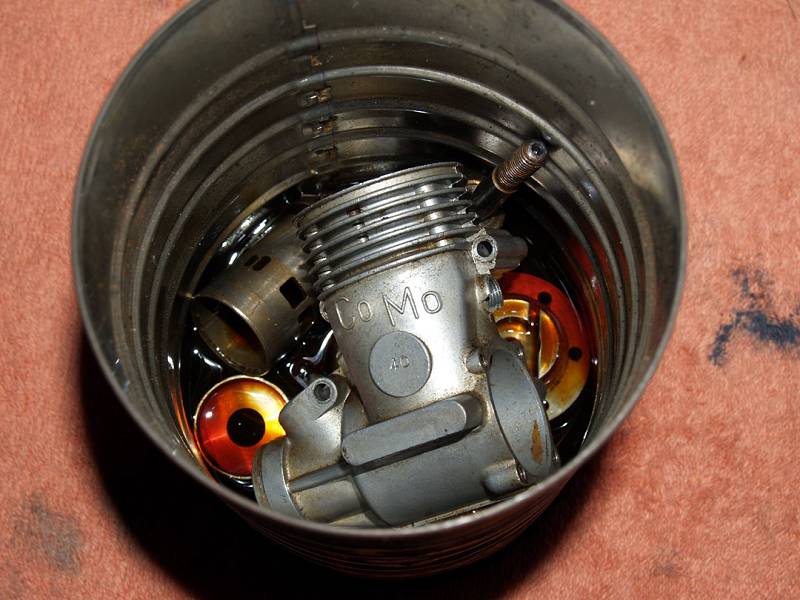

Back on topic.
Here is where my CoMo .40 has resided since about 1978:
Old 08-13-2007 | 04:07 PM
  #31
JollyPopper's Avatar
Posts: 2,684
From: Mountain Home, AR
Default RE: Como Engines
How many RPMs will it turn in that configuration?
