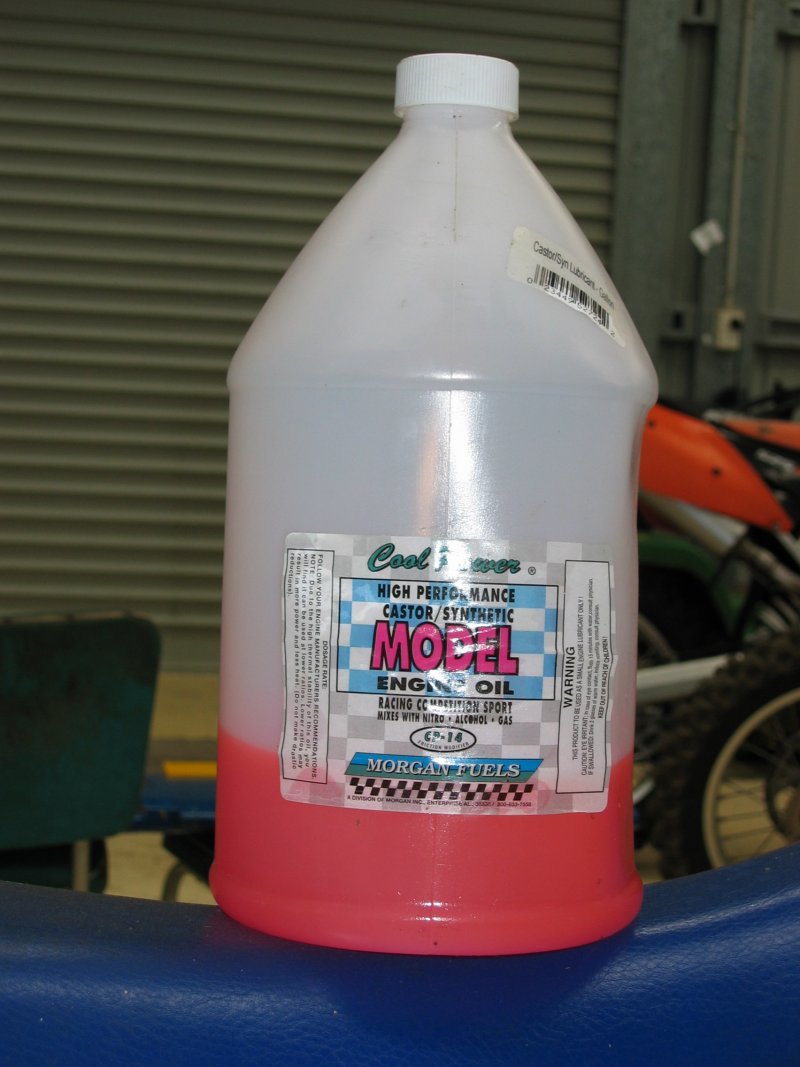

ORIGINAL: speedster 1919
Thats funny I have searched for morgans pink oil for homebrew and all they offer is BLUE and GOLD 2 stroke oil. They said the pink color is added in the factory package.
Not so, grasshopper...
This is what we use, straight from Morgan Fuels - "Coolpower High Performance Castor / Synthetic Model Engine Oil" in pretty pink.
