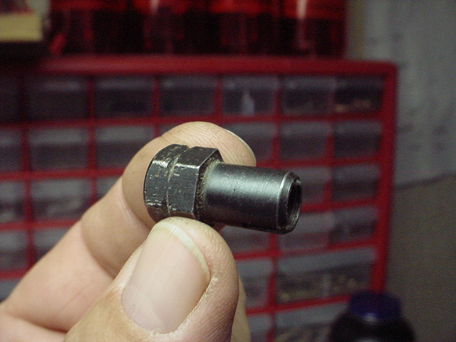

Old 10-10-2007 | 09:33 AM
Posts: 7,816
Received 10 Likes on 10 Posts
From: Upplands Vasby, SWEDEN
Default RE: PROBLEM WITH AN OLDER ROSSI
Hi!
What you do is this! You get an aluminium spinner nut with a treaded flange that extends inside the prop.
Or if you have a Tru Turn alu spinner...a nut with a flange that goes inside the prop.
How many do you want?

Old 10-10-2007 | 09:35 AM
Flyboy Dave's Avatar
My Feedback: (21)
Posts: 13,864
From: Pinon Hills, CA
....you need one of these, only in size 8X1.25, this is the wrong thread pitch.
This Rossi shaft should have the same thread as yours. Rossi .45 & .61 show
the same size and thread pitch.
FBD.

Old 10-10-2007 | 09:41 AM
My Feedback: (21)
Posts: 13,864
....here it is, click on TRU 0826 It's the short shaft kit, with the correct thread.
http://www.chiefaircraft.com/rcmsec/...s/TruTurn.html
FBD.
