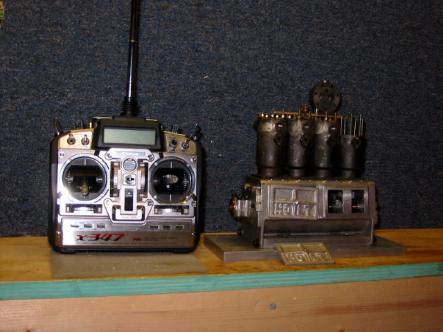

I am finishing a Holt 4 cylinder 4 cycle engine and I need some small valves. The stem dia should be around .124. The length is about 1.375 long. Head dia should be about .4373. Can be metric but close to desimal size. Has anyone got any loose valves out of any engine about this size? I will machine heads to fit valves I find. Thanks Capt,n

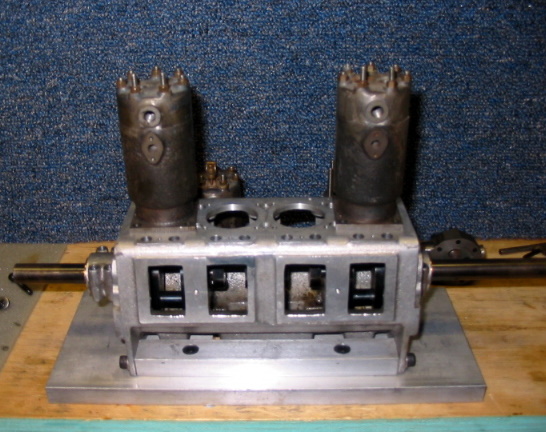

gkmysz: Looks like that O.S. with the .480 face may be close. This engine is a low speed engine...no need for big dia valves. I will post a photo of the cylinder head. Even the .480 head may be to big for the 1.000 inch bore! I need a valve long enough ,looks like it may be a problem??? Keep the data coming. Thanks much.....Capt,n

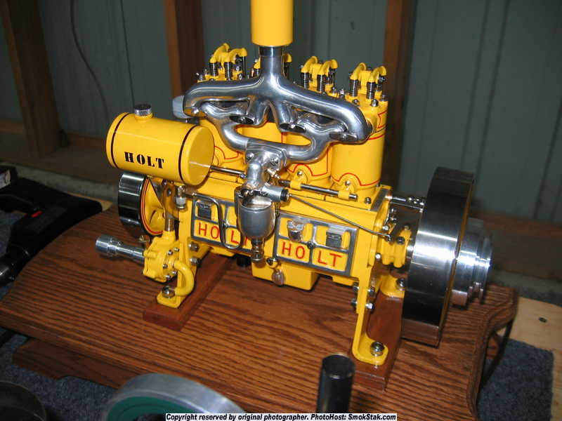

Just thought I would post a couple of photos of the Holt 4 cylinder. I will run it on Glow fuel or Gas/Glow mix. I got the crank in to check fit. Capt,n

Forgive my ignorance. Never seen one of those before.
How is it cooled? Not air cooled is it? I see no fins on the cylinders.
Old 10-15-2007 | 03:27 PM
Posts: 12,957
From: Hesperia Michigan, MI
Default RE: Need 4 cycle valves
Rcpilet: I never seen a Holt engine before untill a person emailed me. I ended up buying the engine to finnish. It is watercooled. It may be too heavy for airplane use. But I could aways turn some finned aluminum cylinders whith steel liners, and make a air cooled version too. I guess some old-time aircraft was water cooled. Not sure of the names might be!! Anyway it sure is fun getting any engine finnised up and see it run. I read one guy has run his on glow fuel. Thats what I may try first. Best Regards,Capt,n
