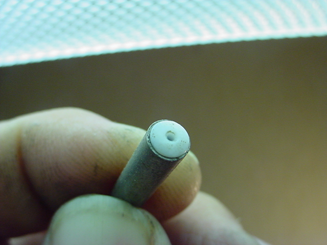

If it doesn't use circlips, it must use the teflon retainers like a K&B.
FBD.

On the 36 . . . .
The piston has a shoulder in the front to retain the piston. In the rear, there is just a straight hole. You can not use a nylon pad because the wrist pin hole comes half way across the rear Schnurle port.
I have pads, that would be easy.

I have the old circlip. To cut a groove would be difficult without a jig to hold the piston on center and a lathe?
I contacted the owner and I'm going to go the nylon pad route
