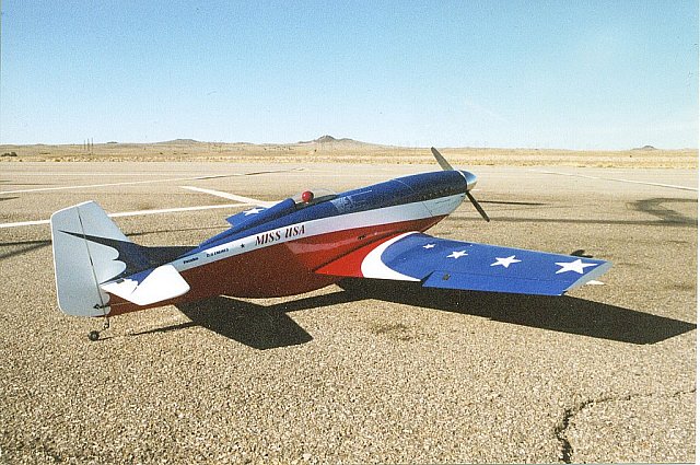

I run an 18/10 prop on mine with a Cline regulator and a glow driver. Not much of a fan of Perry Pumps. 15% Omega. Flys good.
