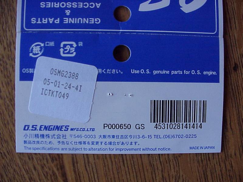

I didn't realize that the discussion under the abouve subject was a manufactures only fourm, So I started this one to continue it. My last post to the above follows. I just added photos of the package tag from that stack.
Bax, you are wrong. I purchased a stack from tower a month or so back that was listed in teh 56 parts and I installed it on my O.S. 52 Carb, which has the same part number for the body. They are both "N" carbs. The 56 version in addition to the stack has a different barrel which changes the mix ratio in the mid range some. I haven't seen the parts list for the 81 yet, but I'm betting money that the same situation exist there where the carb is based on the 70's carb.
Don

I have one of these on one of my 52's

ORIGINAL: Campgems
Don
You're right on the money! The 70 surpass shares the same carb body as the new FS81 p/n 44082100. So the velocity stack should fit.

W8ye, does it do a good job of preventing the spit back?? I haven't had a chance to mount mine and try it yet.

Its not flying season here and I have not run it yet but it fasten onto the carb like it was made for it.
