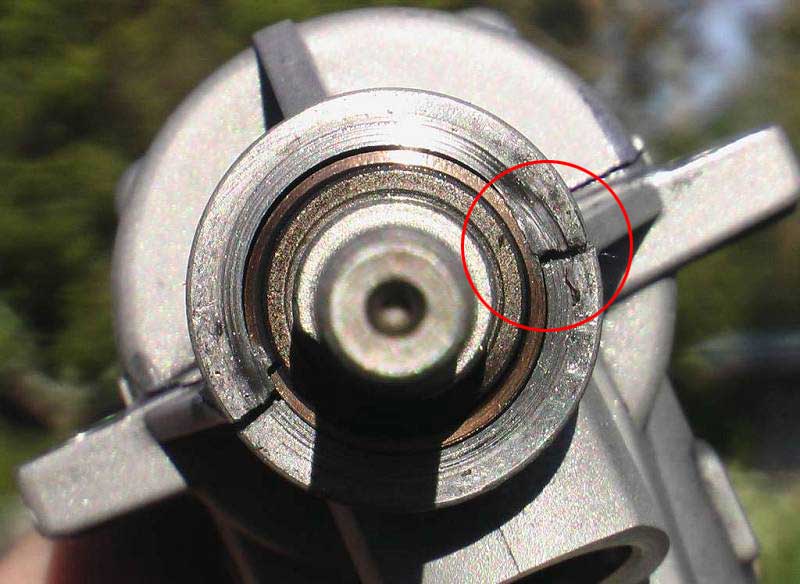

My TT61GP was one of my favorite engines and has provided two years of kick-ass performance on a 40-sized trainer that has been clocked at over 175Kph (110 mph) on the straight and level.
Now I'm no sissy-boy, I fly hard-out so this engine was fitted with a tuned pipe and propped to pull around 15,500 on the ground, unloading to about 16,500 in the air -- maybe a little more in those full-power vertical dives ;-)
Everyone who saw this engine run and saw the plane it was in fly could not believe just how much power it put out and were amazed to discover that it was only a plain-bearing .61 that cost $85 brand new.

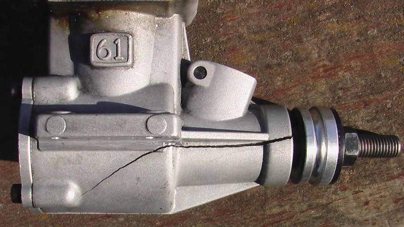

Unfortunately all good things must come to an end and today the engine stopped unexpectedly and left me to perform a perfect dead-stick landing, the roll-out stopping at my feet.
I went to refuel the plane and noticed the engine wasn't its usual self -- offering some resistance to turning.
On close inspection I saw the damage shown in the attached pictures.
Yep, I split that baby right down the middle!
It's worth noting that this engine has never been crashed and has only ever been in the one airframe. The props were always well balanced and it was run on a diet of 5% nitro and 20% oil (the same hi-castor blend of oil Morgans uses in its Omega fuel).
I guess the TT61GP just isn't built to take this kind of punishment but I figure that I sure got my $85 worth of fun out of it. In fact, I'm going to buy another!

Amazing pictures. I wonder if the gouging inside the red circle happened because the case cracked, or if the gouging/binding happened beforehand and caused the case to crack?

I was wondering about that,too. It looks like something hit the nose of the case HARD, and maybe caused the crack. Maybe the prop kicked up a stone ore something??

Can all ou see there are splitted outer ball race? Maybe all ball was rotated around inside and maked hi centrifugal to make cracked outer ball race...?

It seem as a ball bearing in photo, now i can see the engine are a bushing engine... Very rare the crankcase are damaged by hi revolution..

From the damage to the front of the case it looks like a small stone or grain of sand might have gotten lodged between the case and the prop drive and dug itself in, popping open the case.
