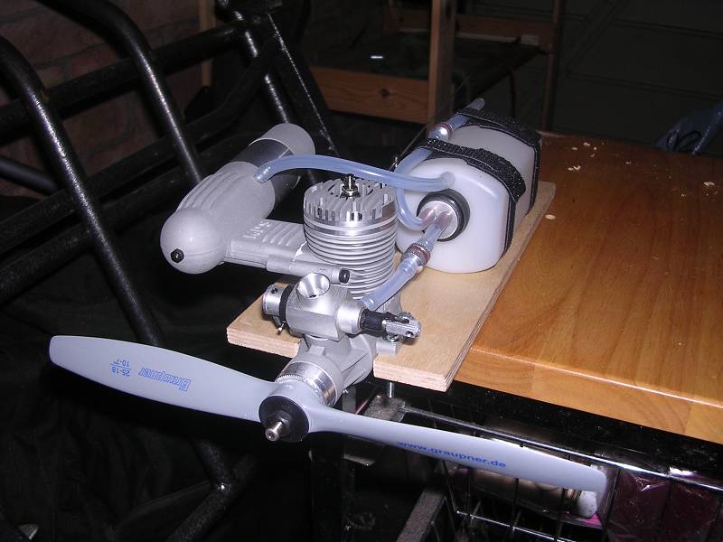

Hi,
I have an MDS 48 PRO and it is still on the bench!! I can`t tune it properly or it just won`t keep it, one of the two. Is anyone else having these problems, I`ve heard that they are hard to tune. If anyone has some advice and tips for me, it would be most appreciated.
Many thanks and blueskies Nige.

Thanks for all the replies, I will try them all. In answer to the question on what I`m doing and the fuel that i`m using is, I`m new to i.c. and i`m going off the user manual so i`m probably doing something wrong, I use an ENYA No 3 glow plug which is what they recommend and the fuel has all the ingredients that they recommend plus what my local model shop told me. I just find it wierd that when I leave the glow starter on, the performance is brilliant and no matter how much throttle I give it, it does`nt matter. Soon as I take it off it either cuts out or when I give it full throttle it dies or it begins to chugger.
Cheers Nige.

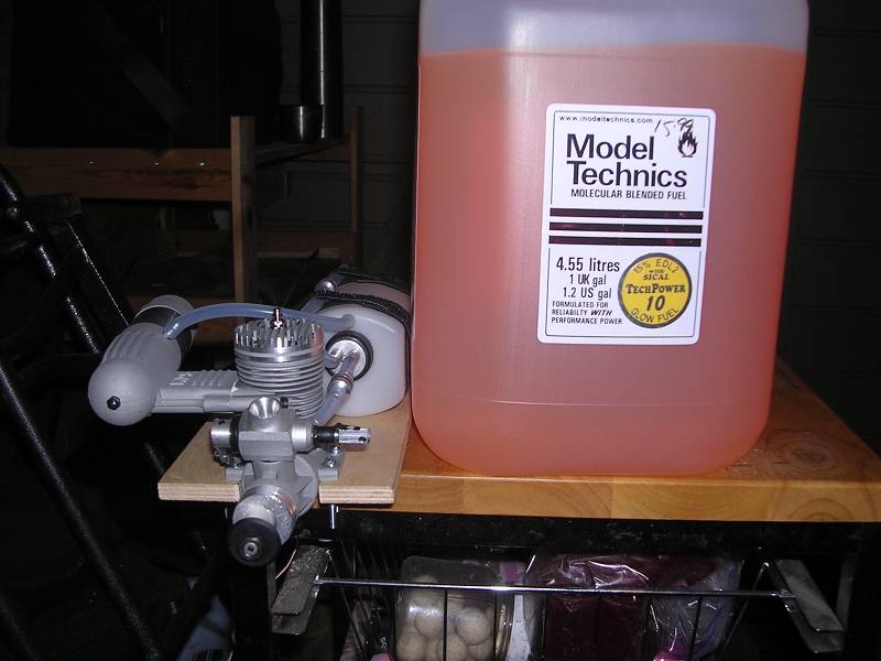

Nige,
Could I assume you are trying to run 10% nitro in that engine???
That is what the gallon just says...
That engine is Eastern Block. Only 0-5% nitro, or it will run badly.
A lot of castor oil in the fuel will also be necessary. That jug is only 15% all synthetic EDL...
Just make it easy on yourself and mix 1 part castor oil with four parts methanol. Use that for fuel.

Jez,
Nige is in the UK, so he must have the Euro version...
I believe no nitro is what the doctor ordered.
As to Enya plugs, their #3 is the hottest, like OS' A3.
It is also what they recommend for four-stroke engines, despite not having a 'shrouded' end.
Their #4 is like the OS #8...
Their #5 is like the OS A5.
