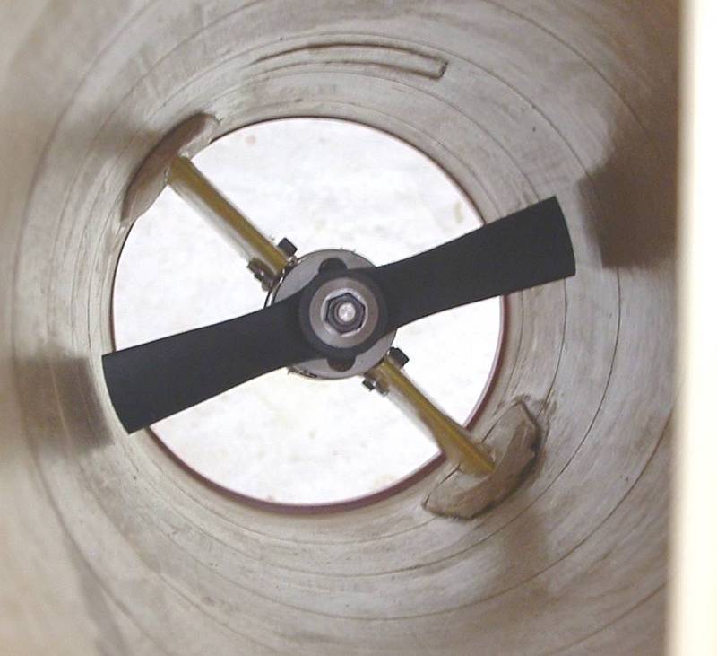

No slight was intended as I use Thrust Hp all of the time to try and predict performance. It is very inaccurate for oddly shaped props. For example I cut a master airscrew 8x5 undercambered electric prop down to 4.1" for use in a Turbo bee (see RCU videos) and mounted it on a stand and measured 19 oz of thrust at 20,000 RPM. Thrust HP says this will put out 5 oz of thrust???
Francis

Francis,
What you have there is essentially a ducted propeller.
The duct around it increases the effectiveness of the prop dramatically.
This is especially so in a static situation, where an 'open' prop may just churn the air, not making much effective thrust...
Besides, what diameter, pitch and most importantly, factor did you dial in.
Surely not the factor for a 'standard' 4.1x5 MA, with those very wide (in proportion to the diameter) blades...
So there are two things; the factor must be ~3 times as large and the duct...

unrealistic juggling of prop parameters will get me above 17oz thrust, (i.e. 24oz@prop power factor 5) because the prop is stalled when operated in free air due to it's very wide tips, and other non-conformancies near the prop hub. Stall sets in at abobe pitch/dia ratio of 1.2. In such small props, the tip vortex covers a major part of the prop disk, so I think there is no calculator around that will predict anywhere near correct at these extremes.
Removing the tip vortex as in ducted fan use, like Dar said, may yield higher values. However, this is not possible in my calculator which is for props, not ducted fans.

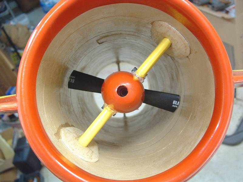

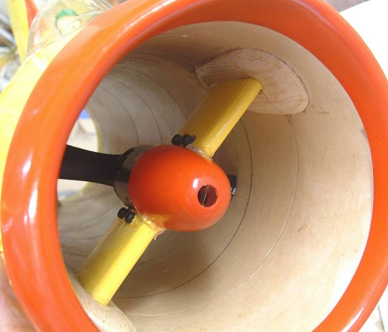

I will measure the inside diameter of the pipe and take some closeup photos of any obstructions. The motor supports are aprox .29" thick, about 1" front to back sanded in a symetrical airfoil and made smooth by being covered in monocoat.

Pe,
The tube is 16.5" long, has a inside diameter of 4 3/16" and the prop is 4.75" back from the front.
Francis

Is the tube straight? (inlet and outlet diameter the same?)

Yes the tube is straight except for a slight lip in the front.
