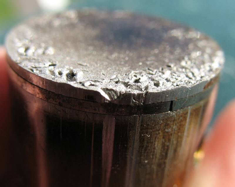

Ok guys, on my second flight today my O.S. 50sx sputtered and died. I found out that I had enough fuel so I checked the plug and it was gone. So I replaced the plug and tried to start it up again and noticed it was making a horrible clanking sound. It also seemed to have much less compression than normal. I was using an electric starter so it turned over a few times[]
I got it home and took it apart and this is what I found. I thought at first it was the element from the glow plug, but I don't think that could do that much damage could it? What could have caused all this? I took the whole thing apart and never found the culprit.........[sm=confused.gif] The piston sleeve and everything else seems to be ok. The connecting rod also has a couple of nicks in the outside of the ring.
Can I just replace the piston, head, and ring?
(and no, I don't have a fuel filter on this plane)

You'd have to replace the piston, maybe not the head? And if the sleeve is bad you'd need to replace that
This would be caused by running too lean and getting detonation I'd say
Looks nasty!
Looks nasty!

How does detonation cause that damage?

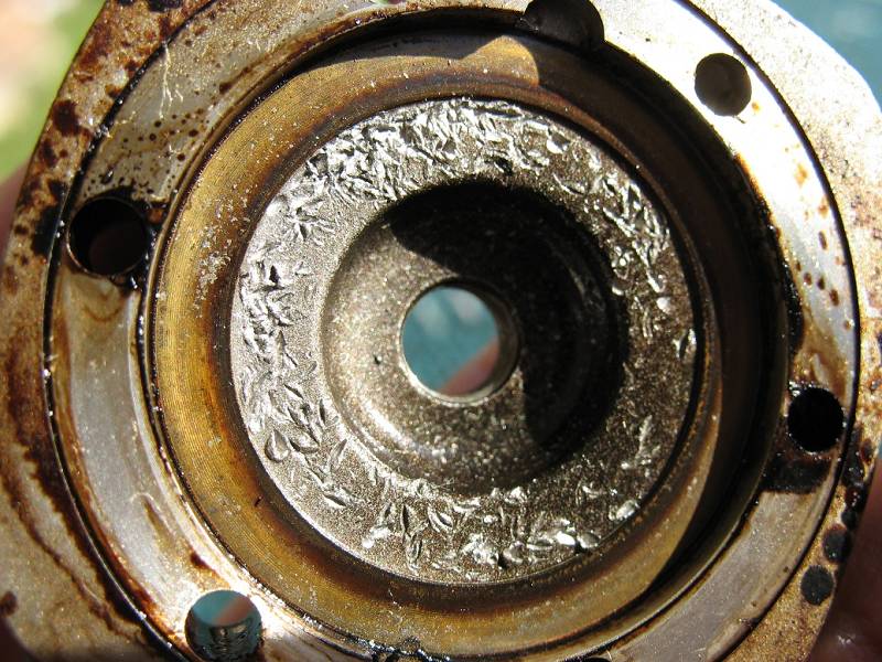

Looks like you had a metal chunk dance it's way around your head. Did you find any metal chunks in your crankcase? How do the bearings look?
I had similar damage due to combination of a rusty rear bearing and some momentary high RPMs(recent post here in the glow forums w/ pics). Not fun.

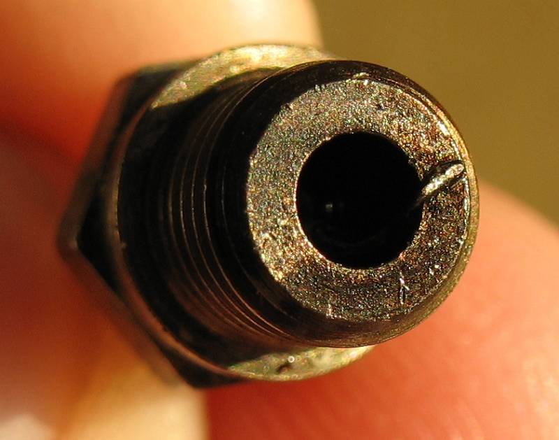

What knd of glow plug was it? It looks like something real hard got loose "like the idle bar"...or it ingested something (bearing parts). Is the ring free in the ring groove? It looks like it took a pretty good shot in picture two. Find a lathe and you "may" be able to clean it up. Otherwise it looks like a new piston/ring.

Looks like foreign object damage to me and at a guess, I'd say it was caused by something much larger than anything that would have come throught the fuel system.
When you say the glowplug was "gone" do you mean it had come out of the head or had the filament disintgrated? What sort of plug was it? did it have an idle bar?
Is it possible that something has entered the cylinder from the bottom end? such as parts of a disintgrated bearing?
As Spetz said - if there is any damage to the liner -replace it too
The sharp edges on the damage to the head would need to be polished out otherwise you will probably get hot spots on them and possible detonation. If it was mine, I would replace the head. Are the glowplug threads stripped or is it just the way the photo shows?
Consider the price of all the spares you will need and compare that against a replacement engine such as the Magnum 52XLS

I would say Lean run . I have seen similar , but that is the very worst I have seen. . I would scrap the engine. Time you buy a piston, ring , head , head shim your around 80$ not to mention bearings, which I would replace If I was going to repair. and I junk it and use for parts.

That's not detonation damage -- detonation produces much more radiused pits. That was definitely caused by a foreign body that has made its way into the cylinder.
I'm picking it's a bit of the bearing cage (yet again).
Strip the engine and I think you'll find that the cage on the rear bearing has started to disintegrate.
That's why *I* don't use metal-caged bearings any more.

I don't know what kind of plug it was but it didn't have an idle bar. The threads in the head appear to be ok. I was actually coming over the runway when the engine started to sputter, so thinking I was getting low on fuel I turned around and the engine died. So it was running for I'd guess 15 seconds from first sputter to when it quit.
The bearings appear to be in good shape, a little rust but that's all. Once I removed the piston/sleeve, the crankshaft felt pretty smooth before I removed it.
Do you really think just running lean could cause this? I'm pretty sure it was running fairly rich. It looks to me like it swallowed a steel bug!
Piston/ring and new head = $80.

Looks to me like its been stamped if not internal FOD maybe external FOD. Definatly not detonation damage.
In my work we seen large 15 litre heavy duty engines swallow all four tulip valves, crunch them up and spit it out thru the turbo. Chances are that you may never know what the object was that did the stamping of the piston and head if it was not internal, as it probably left via the exhaust
Bad Tooth, did you have a look at the small end of the rod? I had a piece come off the small end once and stick the piston to the top of the head.

I have a 50sx that did that. A small piece of the ball bearing retainer had come loose in the engine. I had to replace the rear bearing, piston and ring and dress out a small burr at the exhaust port where the piece left the engine. It has been running good since.

Any chance Bad Tooth of giving us a bottom view of the removed glow plug? From the photos you posted, I agree with the others on this thread in mentioning a serious Foreign Object Damage happened to your engine. In working in the engine maintenance field, I have seen this sort of internal damage before when spark plugs, and valve heads break during engine runs. Since you mentioned that the glow plug did not have an idle bar, I do not feel that the glow coil section could have caused that much deep metal damage. It is possible to clean up the cylinder head, but I would replace the rod, sleeve, piston and ring. The mention of a little rust on the bearings gives rise to just purchasing another engine as adding new bearings( why take a chance with the new parts)would make the repair cost in the ball park of a new engine. From a repair situation, it is not impossible to smooth out the pistion and cylinder head, and just replace the piston ring. How well the engine would run is an unknown.

I had the same thing happen to my GMS 1.20. After a close inspection, I found that the area of the piston where the wrist pin goes through came apart and got ingested. It wasn't pretty.

Something ingested through the carburettor's fuel passage cannot do such damage (since it is too small).
It is either something metallic that was pulled in through the carburettor's air intake (or a part of the carburettor - anything missing?), or more likely, a piece of the rear bearing's cage.
Your engine's rear bearing seems very corroded, but is the cage in one piece?
Sometimes just one individual 'shell' parts company with the rest of the cage and 'takes a trip through the engine', or from your photo of the front bearing, perhaps a rivet holding both sides of the cage together, 'let go' and took the same trip...
Closely examine the rear bearing cage, using a strong light and a magnifier.
See if all the balls are surrounded by a cage-shell on both sides and if all the rivets (or tabs) holding the cage together are in place.
Balls and their shells look very similar, so look closely.
The OS.50SX has been noted, by other people, as likely to consume its bearings.
