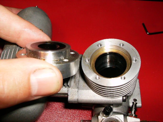

Higher nitro fuel does require a larger combustion chamber volume (lower compression), but it also 'prefers' a smaller deck clearance.
Adding head shims to allow more nitro does decrease compression, but it increases the deck clearance.
This is why 'alky engines' don't run as well, if shimmed up to allow nitro fuel.
Adding shims is the easy way, but if an engine producer really wants to optimize his engine for higher nitro, a different head (lower squish-band with a larger dome) is a much better solution. This goes the other way, if lower nitro fuel is desired

Idealy the squish band should be the same for high nitro and low nitro. But adding a shim makes the squish band taller, but one or two shims should not make a huge differance. It also depends on how well the fuel atomizes in the engine as well. Because of that this will make less differance in the summer than the winter.

The "squish band" also known as the quench area of a head can have a big effect on any engine. If you look at a modern 4 stroke automotive engine you will see an almost heart shaped quench area as opposed to the older open chamber designs. Here is a photo of my new Aviastar .46 check out the quench area. These engines respond well to FAI fuel.
