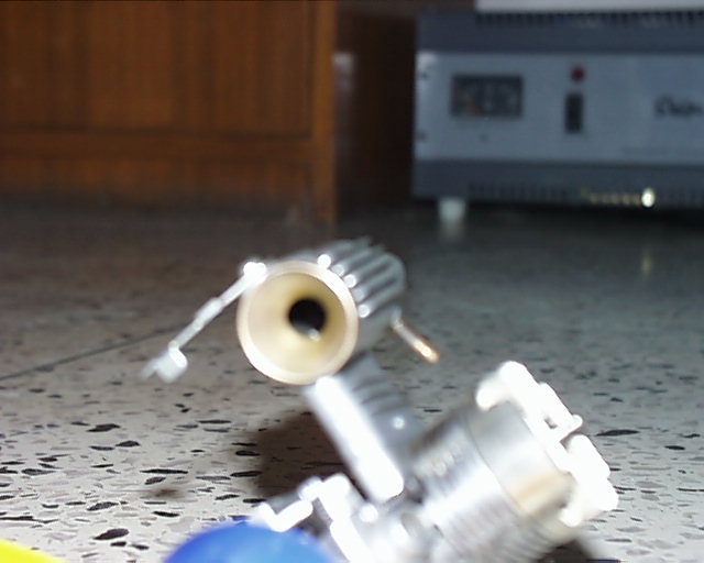

I recently acquired a Fuji 19S (pics attached.) It looks old but fired up the first time and great compression. However its muffler is a bit wierd!!!
First of all, the muffler open in the front and back. I can see through it. Is this normal????
Secondly, its got a flap on the side of the muffler for god knows what!!! My guess is to increase power or is it????
While the engine runs fine, its does not suck in fuel when i flip the prop over with my finger on the air intake but once it starts the fuel flow is cool. Also it only runs straight i.e. stops on nose up or down. Suggests no back pressure from the muffler???

Muffler is normal on older engines. On later ones they closed off the front. The plate on the side is to prime the engine for starting. Try opening the throttle wide open to prime with your finger over carb then go to idle. Tank may be to far behind engine for proper fuel draw tilting plane up or down. Hope this helps.

The valve is meant to be used with a rubber fuel bulb. Open the door, give it a small squirt right into the cyl. then close the door. I think Sullivan still sells them but any small plastic bottle would do. Back pressure was not a concern back then. That is one of the first engines with a muffler. Before then we didn't run mufflers. If you want to quiet it down, put a nut and bolt through the hole in the front of the muffler. Get the centre of the tank up level with the needle valve if you can. Don't know what you mean by nozzle to pressure pipe. I have a bit later Fugi 15 in a combat job. Keeps up with the rest of them on 25% nitro. Name is Gord. Holler back if any more questions. Glad to help.

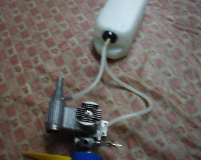

The attached pic shows the pressure pipe as i know it!! It is running from the muffler to the fuel tank and its got threads on it too.
I know that in OS and other engines it is used for providing back pressure to the tank to keep the tank pressurised.
In these old engines, how did one manage to keep the tank pressurised?
Thanx for ur inputs.

To make the pressure system work, you will need to keep the exhaust auxillary door closed. The nipple does look like one for pressurizing the tank.
With the front of the muffler open, there couldn't be much pressure?
Schnurle (Flat top piston) ported engines can take more back pressure than loop scavanged engines (Baffled piston) like this one.

These older engines had smaller carbs than now,so as w8ye says they had better fuel suction. The one I have on the combat plane didn't have a pressure fitting,so I put one on it. Just makes for more reliable running during violent maneuvers. You would have to plug the hole in the front to get enough pressure to be worthwhile. By the way w8ye, these are schnurle ported engines. Up to date for its age.

These mufflers were called venturi mufflers and a number of engines used them when mufflers first started to be used. I remember my old Taipan 61 had one. There was concern about losing power with a muffler so the idea was that the airflow from the prop would funnel down through the hole and cause a low pressure through the centre which would drag the exhaust through the slots which you might be able to see if you look through the hole.
Why has no one mentioned that the head is rotated 90 degrees? With it rotated the engine will not cool properly.
Most flow through mufflers have the exhaust travel around the center tube and exit into the center tube from oppisite the exhaust port. Plugging the front of the muffler will increase the back pressure if the priming door is closed, but it will also cut back on the power available. Some engines actually run best without the pressure line to the tank as a few actually create a vaccuum instead of pressure. On those the tank just vents to the air.

BTW if the airflow through the muffler causes a low pressure around the centre forcing the exhaust gases (in my case more fuel less gases!!!) out thru the back, then the muffler nipple, which is towards the back (refer last pic posted) should be able to pressurise the tank? What say?
