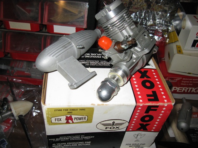

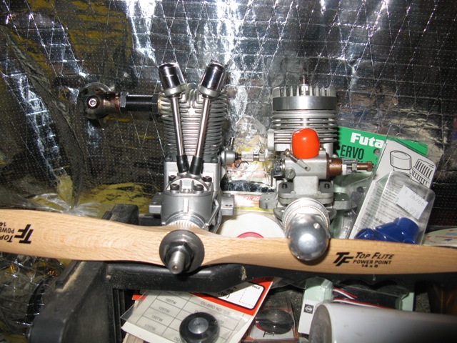

Here is a couple of pictures of the engine. In the first picture you can see where the needle valve has turned to a rust color. Is there anyway to clean that up, or is just normal? Like I stated previously, this engine is brand new never run. I purchased it new from a LHS, years ago. The LHS unfortunately, no longer exists. Just for size comparison, the next photo is the Fox .74 next to a Saito FA-100. She is a big and heavy engine. She is actually heavier then my ST .90s.

Rust color is about the standard color for Fox needles after a few years. Either from rust or castor varnish. There may have been a coating of castor from their factory run up. If so soak it in some fuel to remove it.
The finish is nicer than on any of my Fox's. Perhaps they have refined the castings since Duke passed away.

I will try soaking it in fuel tonight. Thanks!

BH, you might want to check the insides of that .74, the last time I sealed an engine up like that, an Irvine .46, the bearing cages disentegrated from rust. I have never sealed another up that way. I now used Corrosion X and leave them unsealed. Where do you fly up that way, I ride my Harley up route #1 that way and could drop by.

BH, that engine can't too old, it has the newest EZJust carb, just set the airbleed screw about halfway across the inlet hole, find the peak on the HS needle and you're good to go. The carb is a metered carb with an airbleed trim to compensate changes in fuel, props, weather etc.
