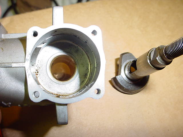

Here's an idea....determine where
the fuel mist is coming from....and resolve the problem.
See this picture....a typical bushed motor. See the thin shim
that goes between the prop hub, and the case ? (some refer
to the prop hub as a drive washer) That thin washer is there
for a reason....is yours missing ?
That thin washer on a bushed motor acts as the front seal.
Some refer to it as the thrust washer.....however, it has
nothing to do with the thrust of the crankshaft. Keep in
mind that the propeller pulls the crankshaft forwards....not backwards. There is no washer on the front of the engine....
that has anything to do with "thrust".

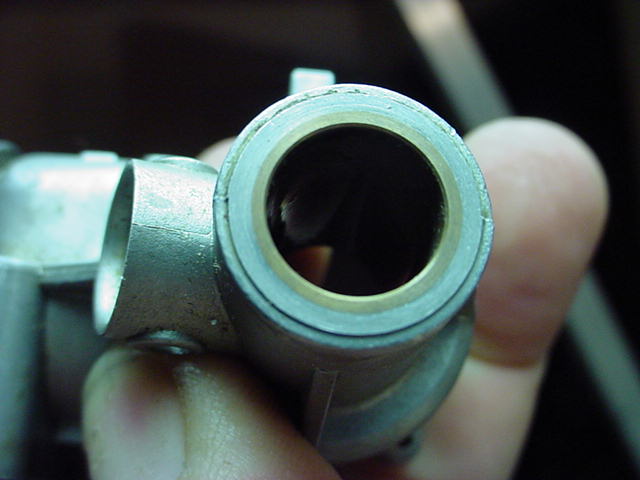

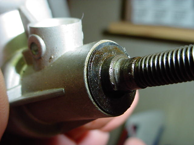

....this is the "seal" on a bushed motor. Without it,
massive air leak and fuel misting will be noted.
Excuse the grounge.....this motor has been un-op for
20 years. It is a close fit, but it is not touching the case.
I do not discount the opinions of my fellow modelers.
However, I've never seen a fuel leak so bad, at the
needle....that fuel mist could be felt on the hand at the rear
of the motor. And....I might say that I've never seen a tank pressurized to the point....that it was blowing fuel out the
connections of the fuel lines.
However, I have seen engines where fuel was leaking out between the cylinder liner, and the cylinder, due to extreme
miss-torqueing of the screws....
Once again....run the motor on the bench if necessary....and
find out where the fuel is leaking from....therein lies the problem.
Dave.

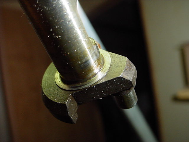

....thanks for the help....If I was at the site where the
offending engine was....perhaps I would be more able
to accurately trouble shoot the darned thing....
I was pretty well convinced that the rearward play of
the engines were taken up....by the clearance of the
rod/crankpin (big end) against the rear back-plate of
the motor. Not one to jump to conclusions....I checked
again....
Yep....sure enough (see pic) after
a few hundred starts....and completely wearing out this
poor old O.S. .25,....I can't see any "galling" of the prop
hub against the crankcase. See, no shiny surface.....save
for one scratch....if ya' look real close....probably from
a crash, or a piece of dirt getting in there.
In fact....the prop hub, and washer do not contact the
front of the crankcase....even when pushed rearward as
far as it will go.
I do know one thing about two stroke engines....a sealed
crankcase....will offer better running qualities....than one
with air-leaks....
Flyboy Dave.
