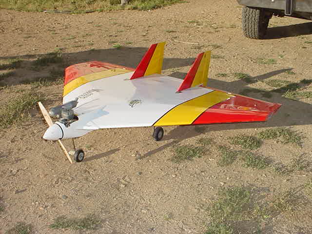

I would like to power my US60 (under construction) with a 0.75 engine. I would like it to be a TH-0.75 but still out-of-stock. So, I have been searching for possible substitutions.
I see the OS-75AX as the last option due to its cost only. I know performance and reliability are there. Then, I have been looking at the JBA075A and supertigre, which is out of stock too.
So, Is there anyone using this engine or would like to provide a recommendation of a dependable substitution?
Thanks in advance,
Pedro

As Turk says, the JBA .75 and .91 weigh the same. The .61, .75 & .91 are all built in the same case. The best one to buy is the largest, the JBA .91.
I have had an SK 90 and an Evo 100 on my US 60. The SK 90 requires a 15-6 prop so a longer gear or bigger wheels might be needed. I also have a couple of Tower .75s and they like a smaller prop. They really hum on an 11-8 or 12-6.
I would pick the JBA .91.
