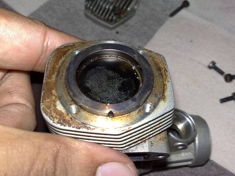

Dear All,
recently broke the connrod on my 55 ax. Shards of the rod probably seized the piston. Repairing will cost more than 60% engine price so bought new one. Now that the engine is gone, I want to know of any mistakes we made. I am posting the pictures (two months out of use, so may be a bit "brown" . Can you guys make a diagnosis?

One by one
fuel used: 20% castor little or no nitro
running time: nearly an year, twice a week about 4 flights each time. This engine had the head replaced in February (I damaged the original head by puting in the glow wrong)
prop: initially 12x6. I replaced it with 11x6 in April after which I did more areobatics
After I replaced the head, most people said that it didnt seem to have compression. But it ran fine.
In July (in the off season), I washed the engine with thinner (paint solvent similar to turpentine. Suggested by my instructor). Problems started after that- would cut off in flight usually when inverted. However, in the last two weeks before it broke, it seems to be running ok. It got damaged in air at 40% throttle as I was circuiting to land after doing all my aerobatics in my first flight of the weekend.

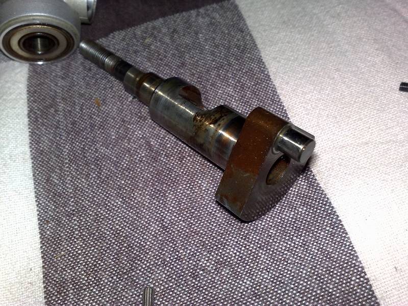

This engine is a very mild mannered engine - you couldnt inflict any damage on the conrod if it wasnt crashed alot. I bet its a manufacturing defect.
Ive been using mine for a long time and much more frequently than you have, with a PSPEC pipe at over 15K rpm. (with omega 5%)
Its my favorite, non-problematic engine. It never cut out in the air or the ground. knock on wood
I suspect bearing/cylinder damage after the thinner cleaning and before the engine got well oiled again. After such an intense cleaning you need to immediately thoroughly oil the engine. I'd suggest filling the case with after-run oil and removing the plug and adding oil above the piston and slowly turning over the engine by hand to fully lube ALL surfaces. Then dump out the excess oil and start with good fuel. I rinse all of my engine parts with clean fuel (oil in fuel) before reassembling a dis-assembled engine. Then oil lightly as above before starting.

G'day I'm no expert on this but to me there does appear to be evidence of dry running on the inside surface of the big end bearing - darker grey streaks. Also, the crankshaft is showing quite a lot of what could be rust and there is also a stain where the rear bearing would have been seated on the crank. The stain on the crank may indicate that the bearing was actually skidding on the crank? The burned castor on the cooling fins suggests that this engine was running pretty hot too. I have never managed to get engines this caked with burned on castor. I suspect it may simply have been running too lean for too long and the cleaning cleared out its reserve of oil causing the big end to run dry and fail. As Bruce suggested, it is always a good idea to really oil up and engine after it has been cleaned.

Thats not rust on the crankshaft counter weight - burned castor oil film. with 20% all castor fuel, the engine could look like that very easily if it was spitting fuel back out from the carb venturi, and that sprayed oil getting slowly burned on the cooling fins and crank case. Its actually harder (for me atleast) to set the engine lean with low or no nitro fuel mix. Because the needle is more responsive, one can easily identify the peak and richen back out. In any case, IMO this engine wasnt run with the correct needle settings. There is just too much varnish all around.

I agree - looking at photos, the best we can do is float some possible ( and possibly very wrong ) ideas. I would like to see what the crank would look like after a really good clean. Best totally destroyed engine I ever saw was a Super Tigre 60 control line speed engine which had a shaft run after loosing its little tooth pick prop and sucked the metal mounting bracket off its fuel tank through its very large rear venturi, managed to get it past the transfer ports and then hammered it into the top of the head from the inside. About the only usable bit left was the prop nut.

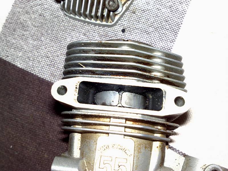

There was definately some loss of compression percieved after changing the head, but that was only in the ear since the engine ran well and tuned fine (even inverted).
However, once through the cleaning, the engine did not do well for a long time. Finally after 2 weekends, it tuned well and ran stabilly. In fact on the day it went, it seemed to be working ok.
I have begun to feel that the engine was running too lean especially since the piston top is all black. I borrowed an 0.46 from my instructor standby as I used this oppurtunity to go to a low wing (Tiger40 on .55AX new). When I removed that engine this week, the piston was still bright. The head had externally burnt black varnish, that happens because the carburretor venturi keeps spitting out fine mist of fuel. To remove that, it has to be washed with methanol and he didnt want me to do that.
I am taking no chances with the new engine. Once I get a grip on tuning it (have not got a handle on that yet, earlier my instructor would do it), I am going to run it slightly rich (quarter turn back from the peak). Also exterior cleaning will be done once every three weeks and with methanol.

If the pictures are close, then the connecting rod seized to the crankshaft and then was twisted off. The crankpin shows bluing caused by high heat. The high heat can only be caused by a lack of lubrication in that area. Something happened to the fuel supply of the engine, making it go lean at high RPM. The resulting low lubrication could not keep the connecting rod from rubbing on the crankpin. Eventually, the friction caused enough of a heat buildup that the rod seized. As the crank continued to turn, the rod would try to turn with it, but since it couldn't, the lower end got twisted off. The brass bushing would be shattered into small pieces, and scattered throughout the engine, along with the aluminum of the lower conrod end.
The only repair is to replace the piston/liner assembly, connecting rod, and rear bearing. The crank can be cleaned with 600-grit wet-or-dry sandpaper. Unfortunately, this is very close to the replacement cost of the engine.

The bronze bushes (bearings) are porous. They absorb and hold oil. During any cleaning of the internal components with a solvent, you need to make sure any oil leached out is replaced.
Leaving a solvent to soak parts, it is possible to disolve and leach out all the oil. The part then needs to be soaked in oil (preferably at a warm temperature) to replenish the lost oil.
An engine started with a lack of oil in the bearings will cause a lack of lubrication until the bearing soaks up enough oil (from the incoming fuel charge) to become "full".

What I can diagnose from your photos.
The crankshaft has some of what appears to be rust, in front of the rear bearing and it seems the crankshaft has spun in the rear bearing's inner race...
But this seems to be a short episode, resulting from a shard of the con-rod lower end having wedged itself between a ball and a race; effectively stopping the bearing, while the crankshaft was spinning.
There is some rust on bearing's races, but it seems there is none on the balls and the (plastic - Touché, OS) cage seems intact.
...I cannot tell why the con-rod failed....
Do you use an electric starter and could you have inadvertently tried to spin the engine over when it was flooded?
Did your engine lose the prop and spun at unspeakable RPM?
If not, I suspect the con-rod had a flaw from manufacturing; a hair-line crack, or something.
If your engine is only one year old, it should still be under the two-year warranty OS gives its customers.
It would be a good idea to contact BAX (Bill Baxter) of Hobby Services; perhaps in the [link=http://www.rcuniverse.com/forum/forumid_133/tt.htm]OS Support Forum[/link].
Perhaps, with the photos you posted, he can just send you the replacement parts that you need, without you needing to send the engine back and forth through Indian customs.
It would cost you nothing to try.

Paint thinner is definitely not the desirable solvent to clean an engine with. It literally leaches out any oil it is in contact with including the pores of the brass bushing.It also causes damage to any plastic it is in contact and dissolves ,redeposits and hardens gunk in the wrong places.
Your engine was literally starved of oil as castor even though a very good lubricant is rather viscous and would need some time to work in while metal to metal contact was progressively destroying the conrod especially running at high rpms. I suspect the lubricating hole and micro pores may have been inadvertently plugged up by a mixture of varnish and gunk dissolved and hardened by thinner.
Use kerosene to clean the internals of your engine after separating the seals and O rings .Wipe dry, apply light oil and reassemble as recommended by OS.
