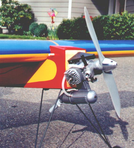

Default Magic w/YS63
here it is.

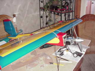

Default Magic
I was flying my Magic with an old K&B .40 having a ball. When I finally decided I wanted a little more power I took a chance and bought a Leo .37. Wow, what a combination, at 3 LB. 10 Oz. this thing takes off in a couple of feet goes to vertical and accelerates
out of sight. using a APC 11-4 Prop.
Bob C.

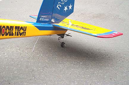

bugsiegal,
I'll take some pictures of the tail wheel and post them here asap. In the mean time, basically I bought a tail wheel assy (don't remember what kind), and installed a control rod from the rudder servo back out the rear/ side of the fuse'. Not sure if that's the kosher way to do it, but so far everyone who's seen it seems to like the way it's done.
Back soon.
Old 04-04-2002 | 04:29 PM
MHawker's Avatar
My Feedback: (16)
Posts: 2,586
From: San Diego, CA
Default pic of tail wheel
here are the pics of the tail wheel on my magic.

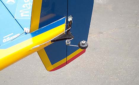

Old 04-04-2002 | 04:30 PM
MHawker's Avatar
My Feedback: (16)
Posts: 2,586
From: San Diego, CA
Default What are u flying on ur magic??
another pic

Old 04-04-2002 | 04:42 PM
Posts: 568
From: brooklyn, NY
Default tial wheel
is that a controlable tail wheel? I think I see a horn but how is it controled?
can you post a photo from the bottom ?
sorry for being a pain..
thanks
Paul

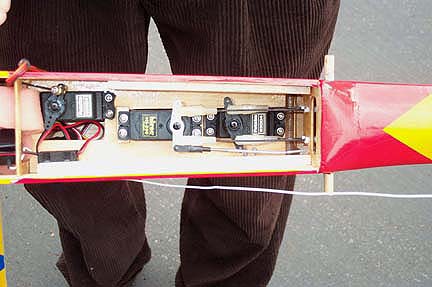

Old 04-04-2002 | 04:54 PM
MHawker's Avatar
My Feedback: (16)
Posts: 2,586
From: San Diego, CA
Hey Paul,
Yup, it's controllable. There is a horn that comes with the tail wheel kit. I did have to modify it. I'll take a pic of it and get it on here. The servo pic shows how the control rod is hooked up to the rudder servo. I'm sure there is a better way to do this, but it works for now. Doesn't seem to be too much for the servo.
Back soon.
Old 04-04-2002 | 04:59 PM
Posts: 568
From: brooklyn, NY
Default I see now.
I posted for the photo request before i seen the last photo of the assembly.
makes sence now.
Looks good. one question though? why not install the tail wheel assembly below the rudder hinge line and run a rod though the fuse? was it an issue of clearence for the elevator or just preference?
I ask all these questions because I may order one of these planes.
