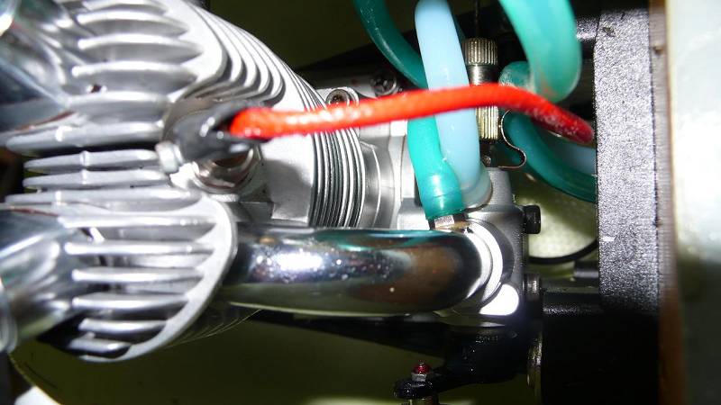

#65
My Feedback: (42)
Joined: Nov 2004
Posts: 548
From: Singapore, SINGAPORE
Ken, i did the same to my saito 125 and did not experience a drop in rpm at all. I tapped the inlet manifold and connected a tube to the breather.No rpm loss and less mess. I was tired of cleaning up the mess.Its installed in a WM senior sports 90 and running 10% nitro and 20% nitro occasionally.
I'm converting a saito 115 next.

Ken, this is my what i did to one of my saito 125.
However, note that you introduced the breather into the MANIFOLD, not the carb body. I imagine you are using muffler pressure or some other means to pressurize your fuel system too, right? If you had experienced a large loss of performance after making the modification, wouldn't you have bought a new manifold, so you could get your engine back up to stock performance?
I just think that this is a failed experiment, and in order to get back to what the stock performance was, he should go back to the stock configuration.

OK, I'm not really surprised to hear that. The small amount of oil from the breather shouldn't make a significant difference. However, you said that more oil won't make ANY difference, and it does. It reduces the amount of actual power-producing material that can be introduced into the cylinder. In small amounts, it may not be noticable, but it DOES make a difference.
The fact of the matter is that the experiment worked for me because i knew it would. I tapped the manifold because tapping the carb body wrongly could cause leaks in the throat. That would mondo trouble!!
