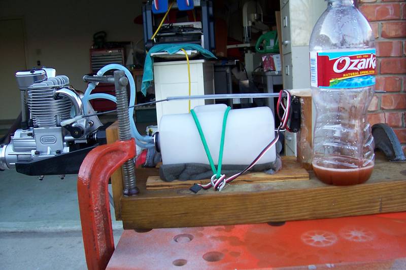

You asked how much oil came out of the vent port.
The fuel tank is 360 cc the bottle is 500 cc.
The engine is 300 rpm fat at WOT, the LSN is set as lean as possible to have good quick transition to WOT.
50% of the tank was run at WOT the rest was run at mid throttle and maybe three minutes at idle.
I would guess a little less than 1 oz is in the bottle (29 cc).

That's rather interesting. Assuming 20% oil, there was 2.4oz of oil in the tank. ~40-50% of that made it past the ring into the crankcase. This assumes the crankcase was already at the average running oil volume and that there was no extra oil in the crankcase, such as after run oil. That's actually quite a bit more than I expected. In that case, I think we could run much less oil than we do in four strokes.

There had been no additional oil added to the crankcase between engine runs.
The fuel, it is a mix of 1 gal Cool Power, 3 gal Wild Cat, and 1 gal Omega all of them are 15% nitro.
This mix yields 17.6% oil (1% castor. 16.6% synthetic), 15% nitro, 67.4% methanol (these numbers are rounded to the tenth).

Wow, I am stunned by the amount of stuff that made it out of the breather, thanks for doing that. As you say, that's something like 40% by volume.
Togatoga and I are now wincing a bit if this is how much oil we are plumbing back into the inlet manifold. I wonder (hope) if some of what comes out is unburnt fuel!

It was thick, I don't think there is much unburnt alcohol in it.
LOL ... I guess its all perspective on what is a lot .... I was thinking that does not look like all that much to wipe off the plane.

And the answer is...
Just spoke with John Haytree who has stripped and rebuilt the problem 1.25.
He said the engine was in lovely condition, everything to tolerance and all looking correctly run-in ... except for the piston, which had two VERY high spots on the skirt making the piston a poor fit in the cylinder. Apparently, in a Saito, the piston should be a very free fit in the cylinder, the ring is what seals it; this is why the skirt often looks worn because there is a degree of piston slap in normal operation.
He believes that the friction from the two high spots was causing a localised heat build up / increased friction cycle leading to the fall off in rpm. The only thing he can think of is the piston may have been dropped or whacked in the factory, distorting it slightly and resulting in the high spots.
But all is well now and the engine is winging its way back to me. I'll post some figures once it's back on the bench. Maybe I'm not a muppet after all.
