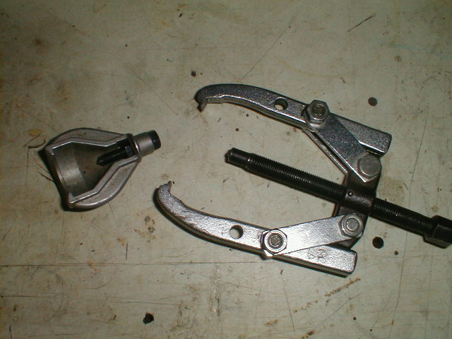

Hello, i would like to ask what type of puller you guys use for removal of the drive washer, no auto parts stores seem to carry the battery post puller, i did have one but it was junk, i see some on line but i thought i better ask, thanks, flyby50....

OS makes a very nice puller that works on their 40 to 61 size engines as well as the many OS clones. You can also buy a small gear puller that works very well. They aren't cheap but work great.

I use one of these to grip the hub then use a puller to pull the whole thing off
http://www.harborfreight.com/cpi/cta...temnumber=7343
http://www.harborfreight.com/cpi/cta...emnumber=93980
You can usually buy these at the auto parts or industrial supply store but they often try to gouge you for $100 for the set

I have used one of these for decades. I've never found a drive washer it can't remove (although sometimes a little heat helps).
http://www.sears.com/shc/s/p_10153_12605_00999018000P

When I replaced the bearings in a couple of my engines, I went to Auto Zone and they let me use their puller in their store. Auto Zone is just down the street from me. If I were to do engines all the time I would buy a puller.

I bought one of these:
I was lucky enough to find it on sale for $29.99.
Yes, it probably is overkill, but it works SO well..... I can be pretty confident that I can pull any thrust washer I will ever need to, and I can use it for other pulling operations as well.

You get on a big block Saito that's been jammed into the ground and you will need a little heat on the hub to get it off even with that outfit. So you didn't do an over kill by any means

My experience with battery terminal pullers is that they are not strong enough to work on any of my engines that have a taper collet type prop drive hub. The fingers slip off and mare the finish on the hub. They just do not have the power to get the job done. They are just a waste of money.

Hello, is it cold enough for you , i'm going with the one from harbor freight, should i get both things you listed or just the kit, thanks everyone for your help..... [sm=thumbup.gif]

just the kit will be fine.
