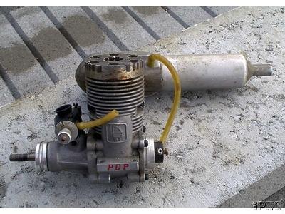

I recently rebuilt an original HB 61 with some mecoa parts, namely rod, piston and ring. The "repro" parts fit very well, machining tolerances were excellent. The engine continues to be an excellent runner. Here is a before shot, believe me, it loooks much better now..........
