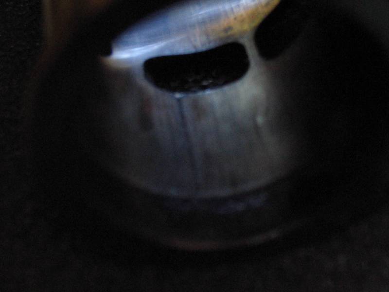

</p><div><span style="font-size: larger">I dissembled the engine today and I discovered that there are scratcheson the liner and the piston. About 2 years ago I had to replaced the bearings (both of them) and there was a scratch on the piston(only justa scratch)and liner probably by time the scratches increase somehow :S</span></div>

Scratches are pretty normal in our engines, as long as they are not so deep... if the compression is good, there is nothing to worry about.

when i put my finger nail in the <font size="2">scratch i get a good grip

Looks like you need a new cylinder and piston. You must have gotten something hard in there. Check your rear bearing as well. The carriages have been know to come apart in some of the TT's. You can a set of bearings from RC Bearings pretty cheap and they work great. Could be yours came apart and scored the cylinder. Could be dirt or sand too. I think these engines are worth rebuilding myself.

About the scratches....if the engines holds compression...it's ok....I would say that if the engine runs at all, no worries... I'm sure that your problem is not related to the piston/sleeve fit....

That scratch is not likely to cause a problem.  I have had deeper scratchs and the engine ran fine.  As estradajae said if the engine has compression it is fine.  Besides your engine doesn't sound like an engine with poor compression.  That would be hard to start hot, poor idle (not just after a flight), and low power.  However, if the scratch is recent it could be causing the piston to jam a bit, extra run time may get rid of that problem.  IMO it is something causing your restarts to be too rich.

It would leak past the scratch, but I doubt it would leak fast enough to be a problem. If it has enough to start hot easily then it has enough compression.
