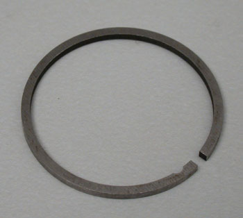

Guys, need some help. I did a search but could not find a post for this question probably because everyone already knows the answer.
I'm replacing a ring in a G75, I got the old ring off, but broke it. So now I'm concerned that I'll break the new ring when trying to get it on the piston.
Can someone tell me the best method for actually putting the ring on the piston? Do you "spiral" it on or do you open it enough to slip it over all at once? or use some other method?
Thanks for the help; this is a new experience for me.

Spiral it on
Lay ring on top of piston
bring one side at gap down the side of piston towards groove
With that one end of gap in groove rub the rest of the ring in a circle around the piston and the whole ring will jump in the groove

The G75 has a pinned ring. The pin is inside the ring groove. Find it.
That's where the ring gap goes
Old 06-25-2009 | 03:16 PM
Joined: Dec 2005
Posts: 190
From: , TX
Default RE: Ring installation
the pin fits inside the groove (or little cutout) in the ring right? not the gap between the ring ends?
Old 06-25-2009 | 03:23 PM
w8ye's Avatar
My Feedback: (16)
Posts: 37,576
Received 11 Likes on 10 Posts
From: Shelby, OH
Correct
ORIGINAL: flhyr
Hmm... to my understanding, the "pin" is supposed to be positioned in the gap between the ends of the ring to keep the ring from rotating around the piston in the piston-groove. If the ring rotates, the ends can catch an edge of one of the intake or exhaust ports in the sleeve, and cause problems.
If the pin is positioned underneath any part of the ring, the ring will be pushed up and held out-of-round, and will not form a proper compression seal. Does the SuperTigre have a different arrangement?
This is basically correct but on the Super Tiger engines, there is a little notch near the ring gap that fits over the pin. On these engines if you place the gap on each side of the pin, it will hold the ring apart and the piston will not gointo the engine

I believe these photos can clear up the issue...
The one with the separate notch for the pin and 'square-cut' ends, is a Super Tigre piston ring.
The other, with the notch within the ring-gap, is from an OS.
