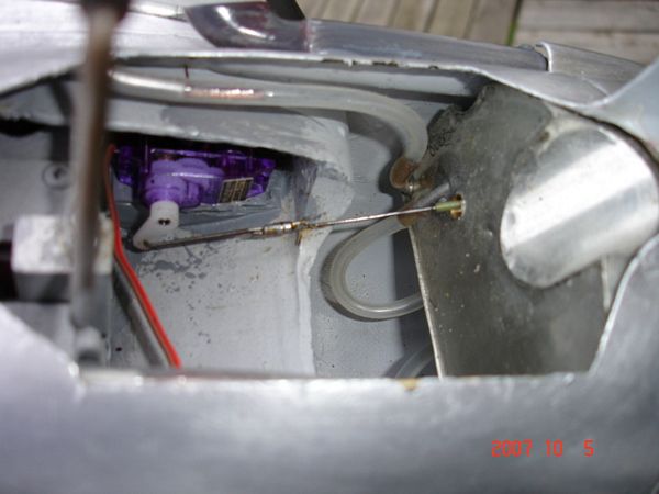

Hi!
Why I ask is because if you mount your engine in a correct way you don't need a pump. A pump always means trouble!
I haven't seen a plane that could not have the tank mounted correctly= tight against the firewall. Al it takes is a bit of modification to the fuselage...or use Tettra "Bubbless tank...or that you sweat solder your own tank.
Here is the 110cc tank I made from 0.3mm tin plate for my Marutaka DC-3.
Second picture is the 150cc Tettra tank in my Q-500 Viper.

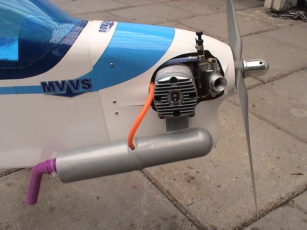

Hi!
Why have the tank on the C of G in such a small glow model? It flies and hovers just as good with the tank just behind the firewall!
In my Yak-50 (gas) where I use a gas engine with walbro pump I don't have to think about where I put the tank, in that case the tank can be put on the C of G without any trouble. But in 99% of all glow engined powered models the tank could be mounted just behind the firewall without too much trouble.
Here is a second example on how an plane can be slightly modified to have the engine comply with the tank rule.
The Great planes You-Can-do.60 with the engine mounted on it's side instead of inverted.
...I'm still curious to see what the engine /tank installation looks like...Please!

Jaka,
It is a normal set up.. side mounted os-70 fs and tank right behind. I cant get the tank to the correct level due to the bulkhead, and without a pump the mixture changes as the tank empties.. The pump will give me outstanding consistency .. exactly why the engines now come with a pump attached
I will keep you all posted
