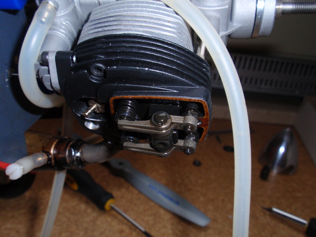

The valve train gets plenty of oil without any mod, so I would say, you don't need anything to do there. But I would say that a sealed front bearing and a shielded (or without shields) rear bearing is all we need here, this way cam gets plenty of oil and the oil wont be expelled through the thrust washer.

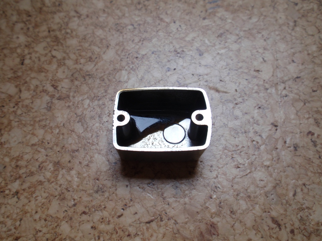

The pics here are when the engine was new, the cam picture shows just a little dark oil on the walls, but not enough to lube the thing.

Old 09-15-2009 | 01:47 PM
  #50
Posts: 1,220
From: Fort Walton Beach, FL
Default RE: Thunder Tiger 75 Four Stroke?
estradajae, do you have pics of the same areas after poking a hole in the main bearing seal? I'd be willing to bet the oil residue is much less dark. Once the engine is well broken in the oil should lighten up anyway.
I'm not at all thrilled with dark oil. The oil that comes out of my 54's front mounted vent is pretty clear and the cam unit does not have dark oil in it.
I just checked with one supplier and longer than standard #76 bits are not available to the best of his knowledge. A pin vise might work.
