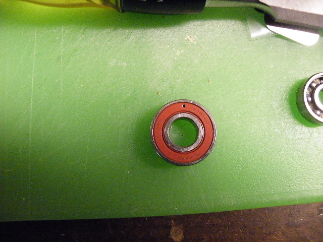

I've heard of people removing cam bushings from smaller OS four strokes and installing bearings. I intend to try it, they do look like they are pressed in. I didn't pay that close attention to the F-75S when I had it, as long as you can get a tool behind them to remove them, they should come out. I doubt they are cast in place. As long as oil is available, I would not worry about cam wear.

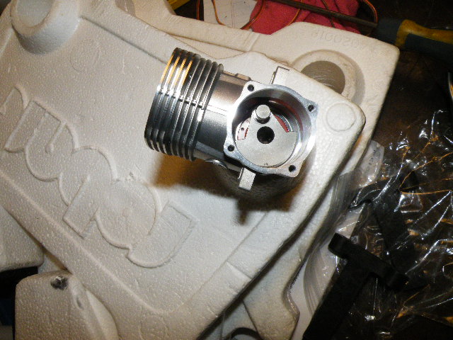

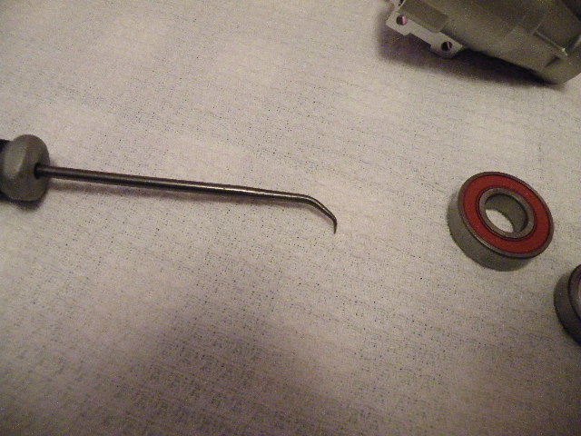

GKA, yes the bearings are pressed in. Not much space to work in but if you are creative you can get them out.
These pics are of my new never run 75s
Rear Bearing seal drilled a .040" hole and installed at 12 o'clock
If you can see the cam gear alignment dot it is slightly before 12 o'clock. That is were it was when I took it apart. Does anyone else find their timing marks the same or different?
I hope to get it together tomorrow and get ready to run it.
#64
With the piston at TDC the timing mark must align with the pushrods.
clean work!
Waiting for the results of your tests =)
clean work!

The push rods would make it at 12 o'clock. Mine came from the factory at 11:30 or 40. If I go one more tooth it takes me past 12 o'clock. I think I will try it this way and if it runs poorly I will readjust it.
#66
the push rods are not vertical to the cam... and the important thing is that the dot is aligned to the pushrods, not to an imaginary vertical line.... so it won't be at 12 o'clock but a little bit earlier.
#69

It's my first post here at RC Universe. This is the best TT 75S thread i've found! Since this is a new motor, there aren't nice reviews or other infos about it.
So, here comes:
What to do with the breather nipple? Until this TT engine, I had only used OS, and the breather nipple is conected to another nipple at the inlet pipe. Leave it open?
Next step is make the bearing's hole modification. <<<<thanks for this tip!
Rom,
Brazil
Just learning english!
So, here comes:
