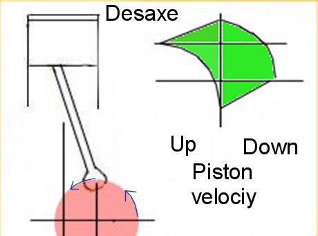

Also, as Pe noted, a lot of engines are built with desaxe which gives a small amount more more leverage when pushing the piston up going one way as opposed to the other. It's not difficult to understand if you look it up and see the pictures of what is happening.

What is desaxe?
EJ
Desaxe means the center of crankshaft are a bit off center of the line of cylinderliner. It will give a low side thrust of the piston against cylinderliner under powerstroke and difference speed of piston.
See the pic..

When the engine is broke in, the wear to near perfect fit happens on the power stroke. When turning the engine backwards, you are compressing with the loaded side of near perfect fit. Normal rotation compression stroke doesn't cause near the load and wear as the power stroke.
Some engines are designed with the piston pin off center to mimick the above illistration.
Rod angles and leverages come into effect with offset cylinders and wrist pins. May be why some engines run better and longer than others.
