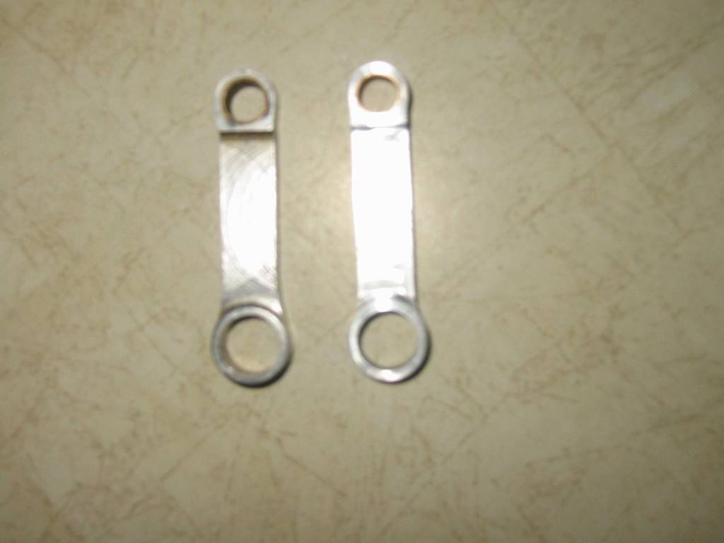

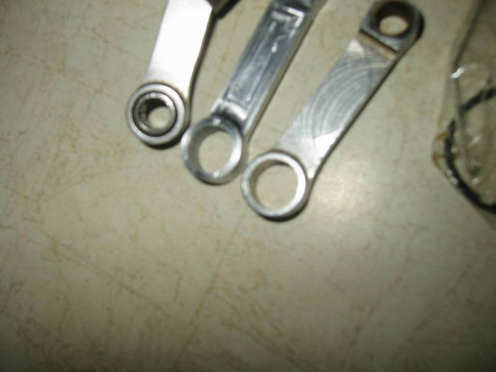

Were you able to find a rod for that NIB Super Tigre?
I made the rod in the center for an OS H-80 engine. It didn't need it as the big end uses a needle bearing. The later model engines came with a bushed rod. I converted one of the other 80's I have to dual piston ring, needle bearing rod.
If you get stuck I can make a rod for you...
