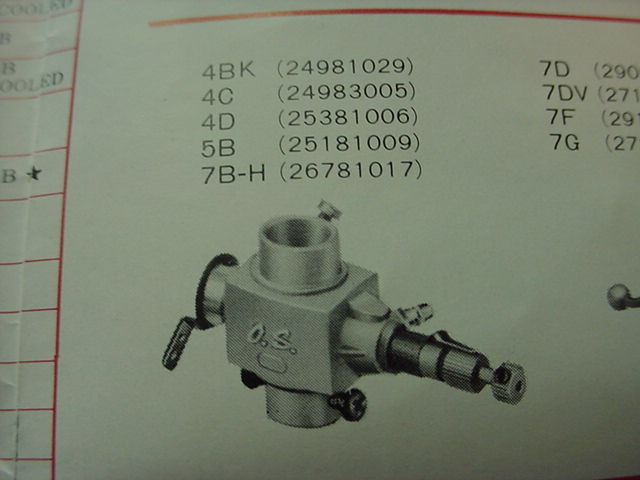

Look what's on the back of this poster, in the carbs....

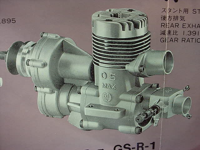

....check out some of the wild motors OS used to make.
These are gear reduction airplane powerplants....
.... .61VF....

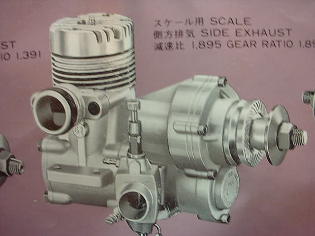

Default .61FSR....
....side exhaust....

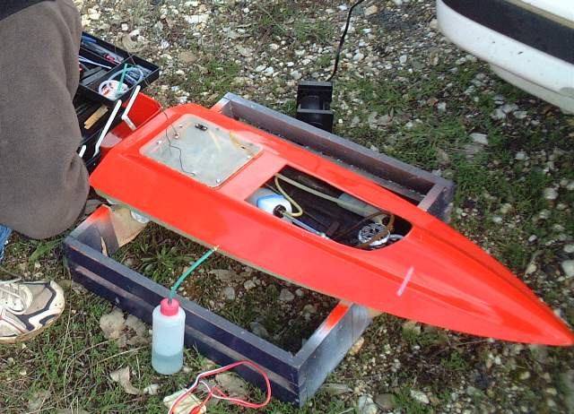

Well? How was it? Yep, a success, of sorts :-)
Engine ran like a dream. Only problem was 2 minutes in, engine cut out, ran another couple of times but everytime, 2 minutes and dead stop. BUT, on the last run I noticed that the water wasn't exiting the cooler pipe at a rapid rate so I am figuring that the water cooling device needs some attention but hey, I can live with that. Thanks for the motor info. I would sure liked to have a re-developed boat and slug one of those FS60M's in, just for good ole grunt :-)
I have included a couple of pics for perusal. Try again tomorrow and see what happens.
Martin

1st time for me at that waterway. They built a freeway right past town and this is where the toen joins it. Perfect. 5 minutes in the car, 2 lakes, easy access and well, the list goes on.
I actually tried once to make a cover for this, with air flow to the head in mind, but it never really worked. The engine only got hotter (Mainly cause I couldn't get the air directed ONTO the head, only over the top of it) and it became all a bit too difficult. If I could direct some air onto the head, without too many mods, I would like to. I did notice on the last run that when the boat was going slow that there was no water gushing out. Before there was at least some water. Only at higher speeds would it start to exit but not enough. Combine that with an ill fitting water ring (Hence the tin foil on the head) and I think this may be the problem. I am assuming that if an engine overheats it will just stop dead?
Marty

....yep.... ....
....I really don't see how those little cooling rings
would even come close to keeping it cool....
....without some major airflow....
.....a complete water jacket (built in)....YEAH BABY !!!

....if you could jack the motor up some....you wouldn't
have to dig so deep into the front deck.... ....
....also, dump some more castor bean oil into the can.
That motor, with minimal cooling, and a relatively slow
speed....needs all the help it can get....

Jackin it up is outa the question as its a solid shaft drive and would require some major mods to realign it :-(
Certainly will add more castor but. And the only reason I ran it at fairly low speeds today was the fear factor :-) Usually it'll run flat out. I gave it a couple today but, well, nervs wins the day.

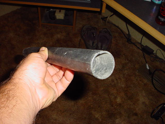

...."tunnel ram"....that's the ticket.... ....
....take a piece of plastic vacuum cleaner pipe. or
something....set it into the bow....glass it, and paint
it red....heh heh heh....put an experimental sticker
on it (just to way-lay the fears of onlookers), and let
'er rip.....besides, if it won't run for more than a
minute....what good is that ? ....
....let it stick out the front about an inch (so it really
looks ugly)....and you don't need a spray rail....
....just tell 'em "it's supposed to look like that".
Airbob....displacement...? ....
