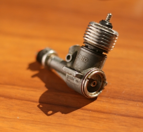

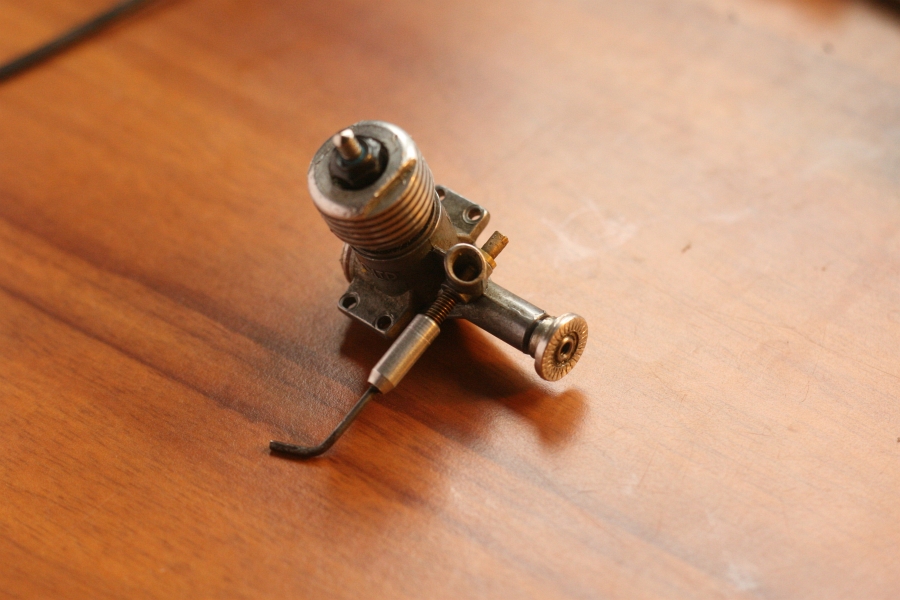

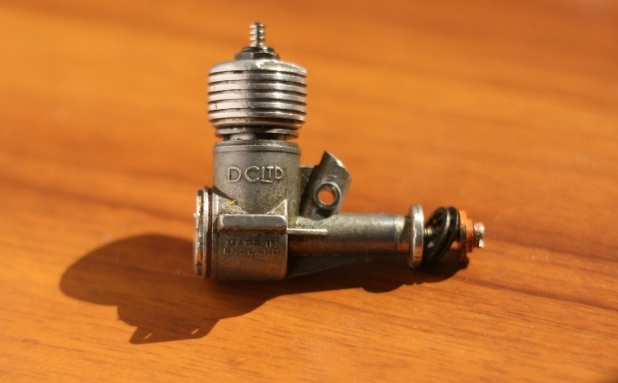

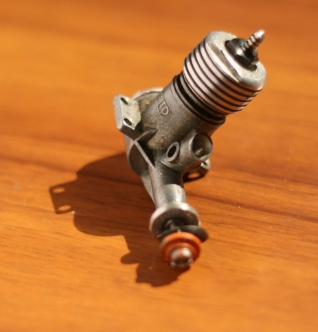

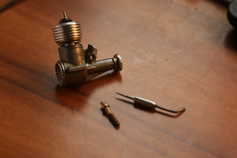

Hello everyone!
This is my startoff in this forum here, so here is brief presentation of myself:I am Fred from Germany, 19 years young. I am travelling in New Zealand right now and this is where I found a little model engine in a second-hand store. I purchased it for 20nzd.. I have no idea about RC at all, I was just fascinated about the fact that such a small engine could possibly even work! So here I have now some pictures and what I have found out so far:
It is a Davis Charlton engine, similar to the Dart f.ex.

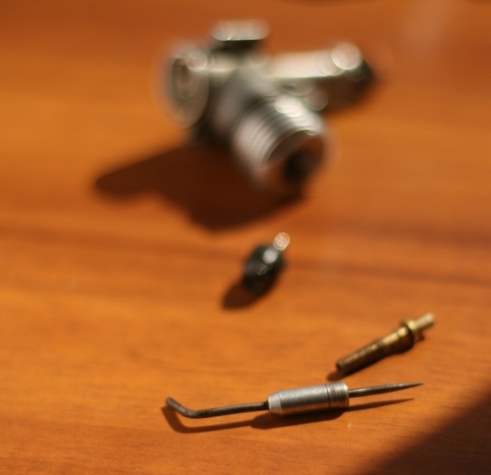

One nut is missing, to fix that brass tube wich I believe is for the mix of fuel and air
I don't have tank

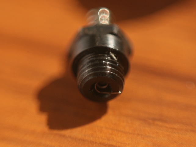

Those are my questions:
What is the voltage for the glow plug?
what fuel should I use?
How could I build a fuel reservoir? Which size?
Which model is it, anyway?
Are there any other parts missing?
Is there any lubrication needed or should I use a mixed fuel?
I think, that's it for now... I would be really happy if you could help me with this, as I set myself the target just to get this thing running!
Cheers, Fred

Somehow I thougt having posted pictures before... Anyway, here we go again!
ID:	1395772   Click image for larger version
ID:	1395773   Click image for larger version
ID:	1395774   Click image for larger version
ID:	1395775   Click image for larger version
ID:	1395776   Click image for larger version
ID:	1395777   Click image for larger version
ID:	1395778   Click image for larger version
Old 03-11-2010 | 08:12 AM

The glow plug is 1.5 v

DC Wasp?
Old 03-11-2010 | 05:55 PM
Joined: Oct 2006
Posts: 714
From: Amadora, PORTUGAL
Default RE: What DC engine is it?
Looks just like my DC Spitfire, but with a glow head.
Could also be the Wasp, as Fiery said, both shared crankcases, if I'm not mistaken (Spitfire 1cc; Wasp 1.5cc)

Thanks a lot for the replies! I haven't found any pictures for the DC wasp...
Is there any general How-to guide for that kind of engine?
Old 03-11-2010 | 09:26 PM
Bone's Avatar
Posts: 433
From: GraftonNSW, AUSTRALIA
My brother has a DC Wasp (0.80cc) but it has a slightly different venturi. On his engine, the venturi does not have that highly forward raked inlet, more upright but still slightly facing forward - if you understand what I mean
Are you able to re-photograph the little beastie against a matchbox for size comparison?
Anyway, it's a great find & a steal for $20NZD. I'm sure a lot of us here are very envious [>:]

The original enquirers engine is a DC Bantam.
Old 03-26-2014 | 05:26 PM
downunder's Avatar
Posts: 4,527
From: Adelaide, AUSTRALIA
Yep, definitely a Bantam and there's a couple of engine tests on them at http://sceptreflight.net/Model%20Eng...sts/Index.html which may help the OP with some answers. Note that it needs a short reach plug. There are some bits missing like the spring starter and the rear integral fuel tank but that's not a problem. When fitting the spray bar through the venturi, there's a tiny hole in the middle which is where the fuel sprays through and the spray bar should be tightened so that the hole is just barely out of sight when you look down into the venturi.
Old 03-26-2014 | 06:04 PM
Joined: Jul 2005
Posts: 1,605
From: Upper HuttWellington, NEW ZEALAND
Absolutely a DC Bantam 0.75 cc-in production from late 1959 until 1970. The reason it appears similar to the Dart diesel is that it uses the same crankcase casting as the Dart-machined slightly differently, and has the same stroke (the top end however is quite different, to allow for the increased displacement of 0.75 cc versus the 0.55 cc of the Dart.) Reasonably common still on Ebay, they were quite gutless-but started and ran well.....which is what I suppose is important in a beginners' engine. The DC Wasp-which replaced the Bantam in 1971-was a much better engine. Run it on about a 15% nitro fuel-and as pointed out it should have a short reach plug. The only point to be careful with is the head gasket-which is a very narrow and thin fibre one-and easily damaged. Don't unscrew the cylinder fins from the cylinder liner if you can help it. When new, they came with an integral tank attached to the backplate-this was cylindrical (not rounded like the Dart one), from spun aluminium, and had filler, vent and feed nipples riveted on. It was of adequate capacity for a FF model, but of little use for any other type of usage so often removed.
What to use it in? seeing as the original poster is German, he might like to put it in Graupner 'Topsy'-which would be a very good match for it, size wise.
.....a couple of afterthoughts-it runs best on 6x3 down to 5-1/4x3 props-and there is (or rather was) a radial tank mount accessory for it which also interchanges with the Dart-this screws into the crankcase in the place of the normal backplate, and has the same mounting bolt layout as a tanked Cox reed valve engine.
