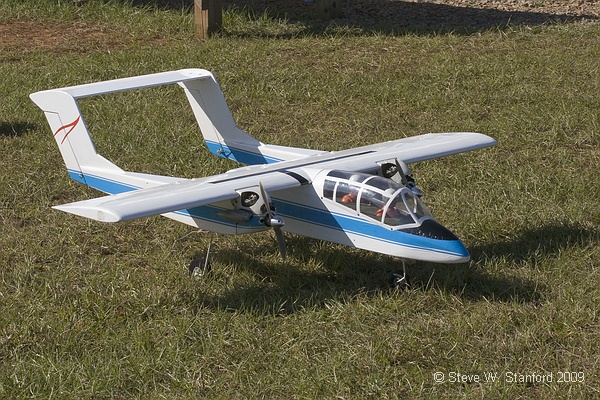

I like the 25 size engines also and have no problem finding them. Look on ebay and or RCU at OS 25 FSR or SF - they can usually be found for about $30, some like new. I keep about 10 or 15 on hand for my twins (also the 28's), very strong, reliable and last forever -
