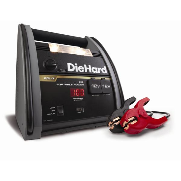

Old 11-14-2014 | 07:50 PM
Joined: Jul 2007
Posts: 38
From: Rio Rancho, NM
Hello flyers--I have a new Sullivan Dynatron .What is the best battery to use?? I have 2-12volt 7 amp batterys. I want to start engines grom os 120 up to 55 dle gas. What should I use ??? Thanks Chuck

Old 11-15-2014 | 10:13 AM
blw's Avatar
blw
Joined: Mar 2004
Posts: 9,449
From: Opelika, AL
Chuck- I went through the same thing like you are. This is the best answer that SrTelemaster150 sent us:
The Sears price is about $60 which means this is a sale item. I paid that for my 650 amp and this one is the 950 amp. You use a/c to recharge it. It weighs half of what a lawn & garden battery does. And it turns the Dynatron over like you wouldn't believe. It's loafing when it turns over my Saito 125. No more lugging around batteries for me, and I can use it for jump starting cars, lawn mowers, etc too.
Name:	Diehard jump starter.jpg
