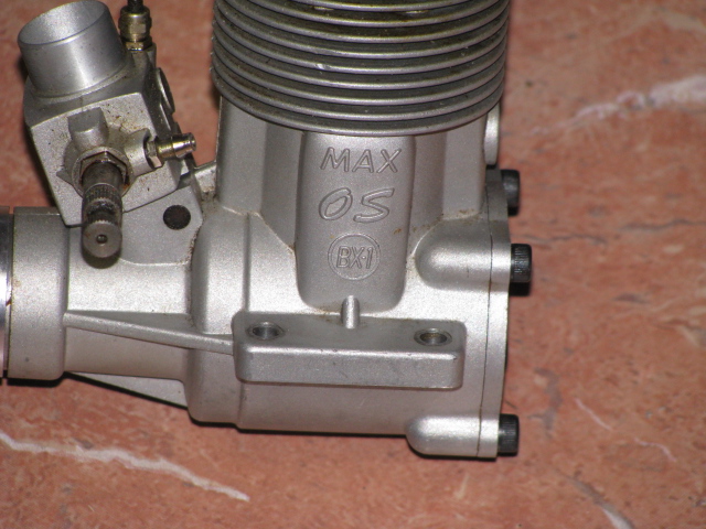

I Purchased this engine off of RCU several months ago, but I forgot what engine it is. I think that is an OS 1.08 FSR ring engine. the only markings I can locate on the engine is on the side BX-1 and under one of the mounting lugs is either FR, FRI or FR1, the I or 1 (What ever it is) actually looks like a Colon (The Punctuation mark one, not the digestive tract one!) made with two verticle lines, instead of two dots, thus the confusion as to what it really is. Anyway, here is the question part of the post. This engine doesn't seem to have much compression, as I can hear leaking through the carb as I turn the prop. Can I just replace the ring only, then re-break in the engine, or do I need to replace the Piston, Cylinder and Ring?? any help, hints or ideas would be greatly appreciated. I have added some pics to help in the identification of the engine..
Thanks again, Craig.

You can get a ring from Frank Bowman
[email protected]
Frank Bowman 1211 N Allen Ave Farmington NM 87401-3568. USA Phone: (505) 327-0696
108 FSR BX-1 16 X 6 prop 9300

Before you go tearing it down, run it. You may find it has all the power you need after a good warm-up. Congealed oil some times sticks the ring in place. A good running, loosens it all up and it runs good. Worth a try before you take it apart.

ORIGINAL: SeaJay
You are correct there.
You can get a replacement ring from Frank Bowman, he is the "ringmaster", I just recieved some rings from him last week. Unless your sleeve has severe damage, you will probably have to reuse it, this is no problem though. The problem is that this engine was discontinued a few years ago and replacement parts are getting scarce.

The engine itself appears good shape on the outside.
Cannot say the same for the header pipe though

Run it before taking it appart, ringed engines often feel like they have bad compression specially if they sat a long time without being used it also take a long time before the ring sit propelly. the old K&B .40 used in sport-40 Hydro class took a gallon of fuel trough it before ready to race!
