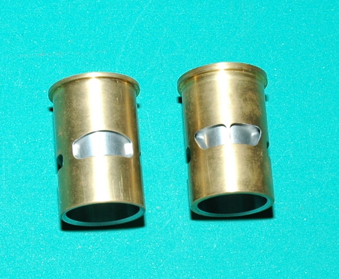

I aquired my HB.61 PDP through a trade. Rather than try to break it in myself, I had a friend in Denver that was a wiz with engines I I gave it to to break it in for me. When getting it back to Minnesota, a slight adjustment was all that was needed on the high end, and WOW it ran well. But camparable to my Magnum .61 XL and my ST. 51, the economy is REALLY bad. Thus proving the addage- if you want power, you will pay for it.
My friend in Denver explained how the Perry Directional porting works. Even he was impressed with the power the HB PDP put out. Unfortunately, he passed away last month in an ultralight accident.

Now again going a little off topic. If you guys are changing P&Ls have you looked at the P&Ls that were offered by Performance Specialties?
I'm showing the FSR on the left and the Hanno on the right please note the exhaust ports and materials.
Now why this is on topic is I want you to notice the shape of the port. The FSR is an arched port. It allows the exhaust port to open and closes slowly as the piston goes up and down. This makes for a milder but very good response to the pipe. The Hanno sleeve has what is known as a more muffin shape the port is very wide at the top this only narrows towards the bottom to make room for the transfer ports. Both sleeves are mild pipe timed. But the Hanno has more area and as a result will respond to a tuned pipe better.
Also Please note the "gold" color of those sleeves. This is something you don't see much anymore. These are from the golden era of the high performance 2 cycle engine! That shiny stuff on the sides of the ports is real chrome! No nickel here!!!
Friends don't let friends fly nickel,
