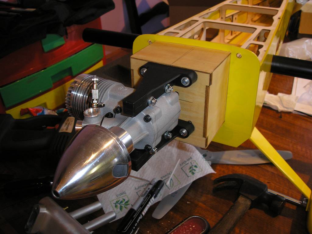

Thought I'd kick off with my Moki 135. I live in the UK, so bought mine from just engines. I followed the instructions to the letter and mounted it in a Funtana 90. The engine was run-in slowly over the course of a full weekend - then I hit the flying field. The combination of dependable tick-over and massive power resulted in an awesome thrust to weight ratio, so the Funtana was limited only by the boundaries of my piloting skills. I clocked a few hours flying time with it over the course of the summer. Sadly, as is often the case, work commitments and other time constraints meant that the Funtana was moth-balled for over a year. Gutted. Just as it was starting to get really good.
When I eventually got the Funtana out of storage, the Moki 135 clearly wasn't right. I really couldn't figure out why - I'd drained the tank, kept it dry, used after run oil, maintained a constant temp. Every time I started the engine, it would simply refuse to run at anything higher than a fast tick-over. Opening the throttle just made the engine stall.
Both internally and externally, the engine looked as good as new.
I looked at the tank and fuel lines. Nothing was obviously wrong, but I decided to change all the silicon fuel tubing with fresh lines and run with a 3 line setup. I've always used 1/8th " tubing for my Moki, so that shouldn't have been an issue, however, I had noticed that the copper fuel pipes supplied with the Funtana fuel tank are really designed for use with smaller 3/32 " fuel tube. So safety wire should be used to ensure a sound fit. As the tank was being converted from 2 lines to 3, I changed all the metal pipes at the same time. The soft metal pipe I used was described as 1/8th ", and seemed slightly thicker than the Hangar 9 stuff. I fitted a clunk to the fill line and a ceramic filter clunk to the main fuel line. So far so good.
Got the engine re-fitted to the plane and tried again. Disappointment! The engine still doesn't run correctly and further more, adjusting the carb seems to make no effect. Time to look at the carb.
Now this is where I made some rapid progress. The carb was actually fairly clean, but because the Moki design is so precise, I noticed that a very small amount of Castor 'gum' had the rotary low speed adjustment dial sticking to the rotary slide. Needless to say, this was easily remedied by de-greasing and the carb was re-assembled.
Fitting the carb back onto the engine, I noticed another slight issue. The rubber o-ring that seals the carb to the intake on the engine didn't actually appear to be snug. Sure, there was no gap as such but the o-ring definitely wasn't being squeezed between the carb and the intake. The carb body, where it passes inside the intake of engine, appeared to meet something solid and come to rest BEFORE the o-ring has a proper sealing action. I fitted a second o-ring and re-fitted the carb. Bingo! A nice, snug seal is achieved.
Now, when I started the engine - HEY PRESTO! It works. From cold, the engine does sometimes run in reverse before coughing and spinning back in the right direction. It's strange like that. It doesn't really matter which way you start the engine, the Moki decides which way it's going to run for the first couple of seconds! LOL. A word of advice: If your aircraft starts rolling backwards, remember not to try grabbing it through the prop!
Thereafter, and with careful tuning, the engine can be set to run like clockwork. It's amazing again - just like it was after I'd just finishing running it in the first time. It will tick over all day - yet respond instantly when you open the throttle.
The way this engines spools up a 17x8 prop is amazing. I can't wait to get back to the flying field again. I'll up some videos of it on the ground during the tune up, so you can see what I mean. In due course, I'll get some decent flying videos sorted. In the case of the Funtana S90, lots of people hailed the YS 120 FS as the engine of choice. The Moki 135 is the genuine 2 stroke alternative to that engine.

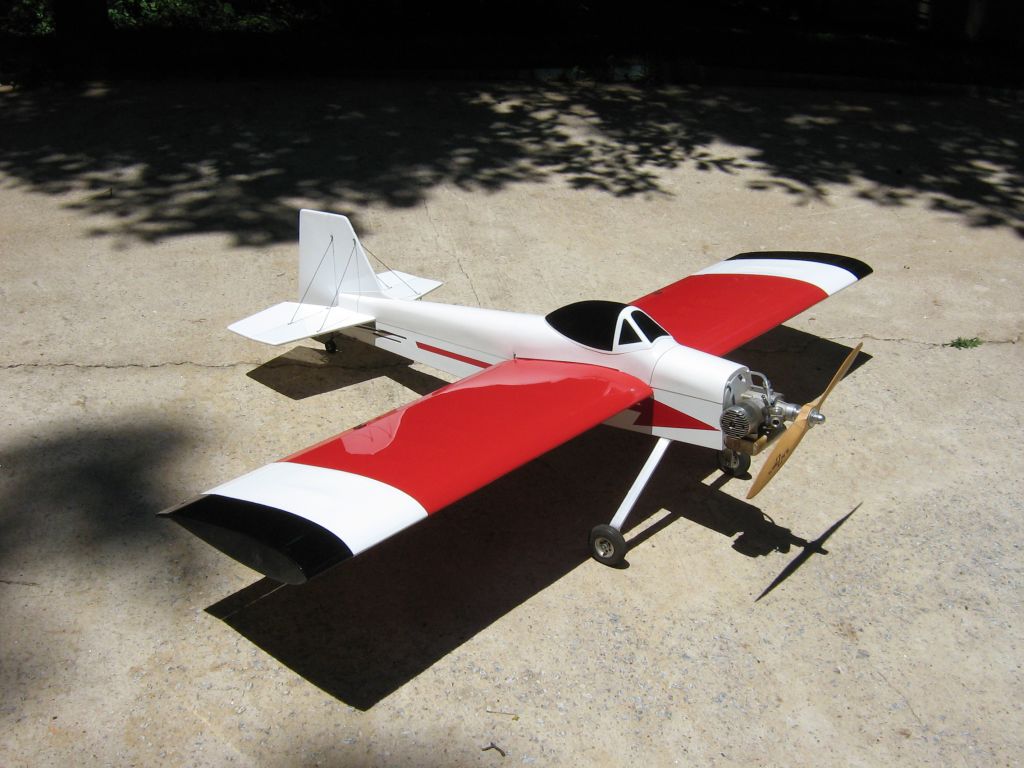

That's a nice clean looking engine. That would go nice in my 55" Cessna! How old was it when you sold it? And what did you fly it in?

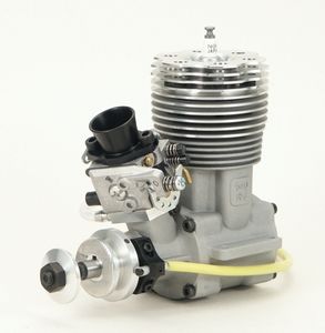

It's difficult not to like the Moki 1.35, from the moment you open the box. It has a very solid feel about it and the parts have a 'machined from billet' look about them. Lovely! The only problems I've had with mine have been brought about by my putting it into storage. I can forgive it for having a little sulk!

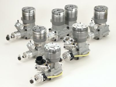

It's interesting to see all the petrol versions - I wonder how they perform? I'm thinking about building (...ahem, 'slotting together') another Funtana, the X 100. My wife can 'have' the old one. She doesn't fly, but I'm sure she'll understand.

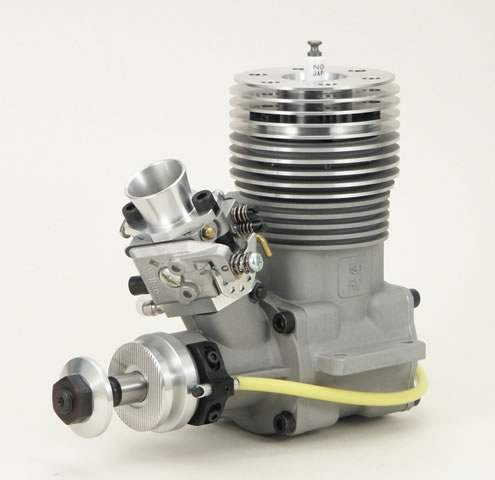

<actinic:carterror prodref="249"></actinic:carterror>We have just received a very limited number of the original Moki 1.80 petrol engines made by the genuine Hungarian factory. Fans of the Moki engines will already know that this engine is Very easy to start and operate, it throttles like a glow engine, has very low vibration and is a nice compact size (low weight plus very slim).
We can supply a variety of exhausts to suit, the BCM mufflers for the 1.80 glow will fit and we can make our own J'EN inverted muffler where a nice slim profile is required.
Our own tests of this engine a few years ago resulted in an impressive 20lbs of thrust! Very good for 1200g weight plus ignition.
As with the entire Moki range, we have full stock of spare parts.
Each engine is bench tested before despatch so occasionally there may be a 24 hours delay from order to despatch</p><hr />The above was a cut & paste from the Just Engines website. The Gas version appears to have needle bearings on the connecting rod! The Walbro type carb is a big plus too. If it works out...I will add more photos & data. With 20 Pounds ofthrust...it should pullgood! Capt,n<hr />
