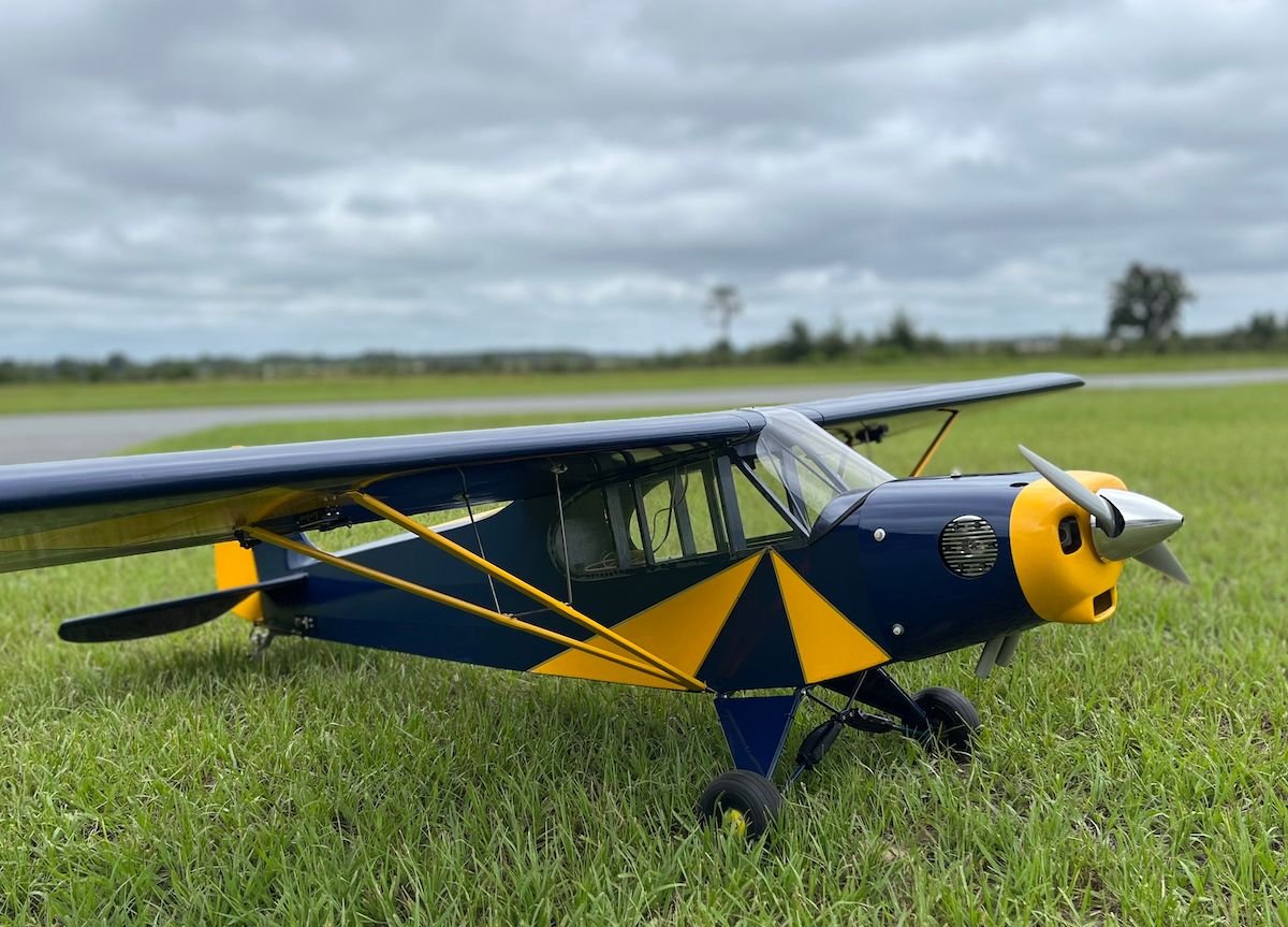

See my post #34 above for some ideas. I'm still running large Moki's but now making my own FAI (o% nitro) fuel, most recently in a 1/4 scale clipped wing Cub
https://cimg2.ibsrv.net/gimg/www.rcu...f14950498.jpeg
. My old recommendations still apply.
