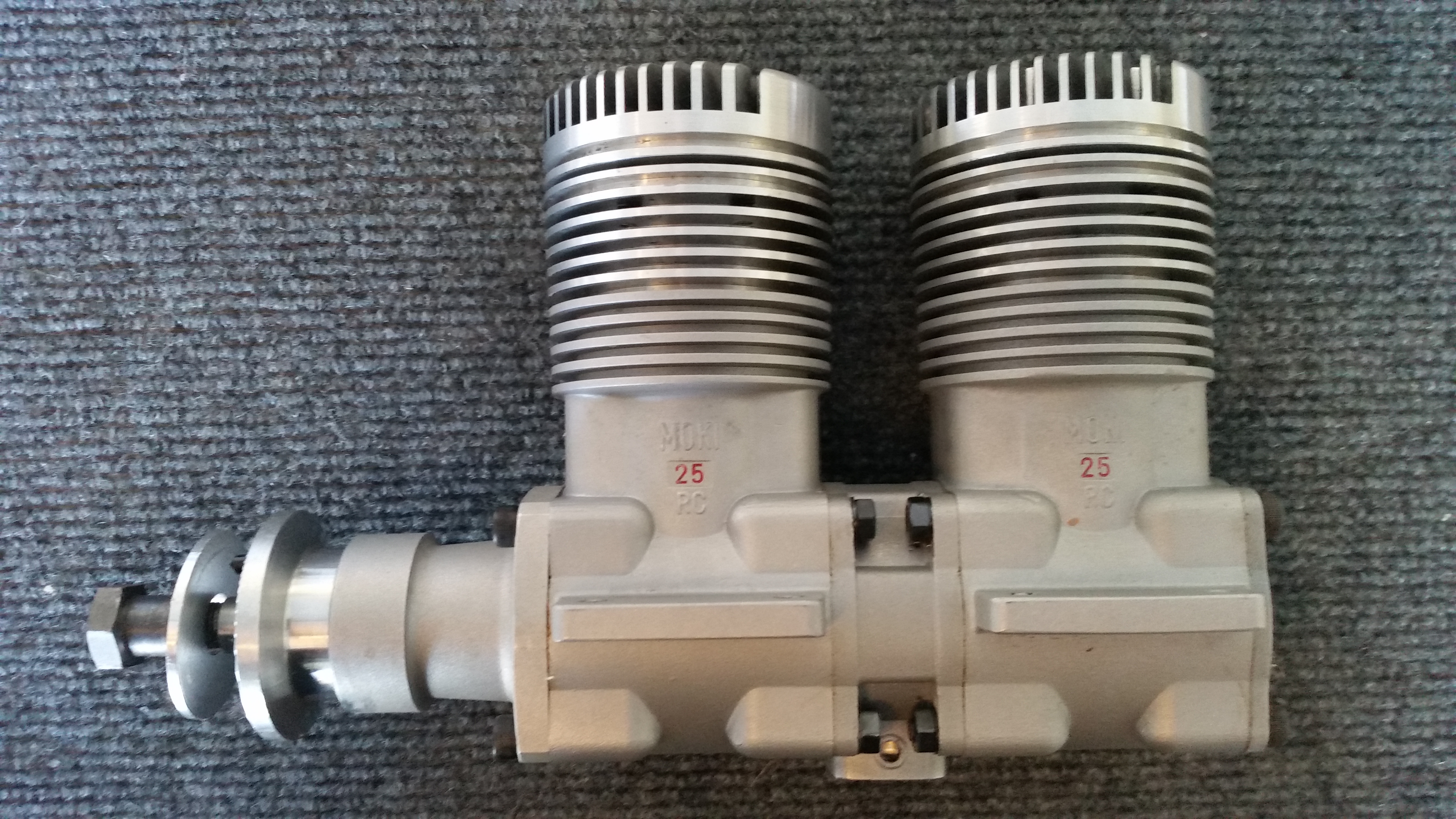

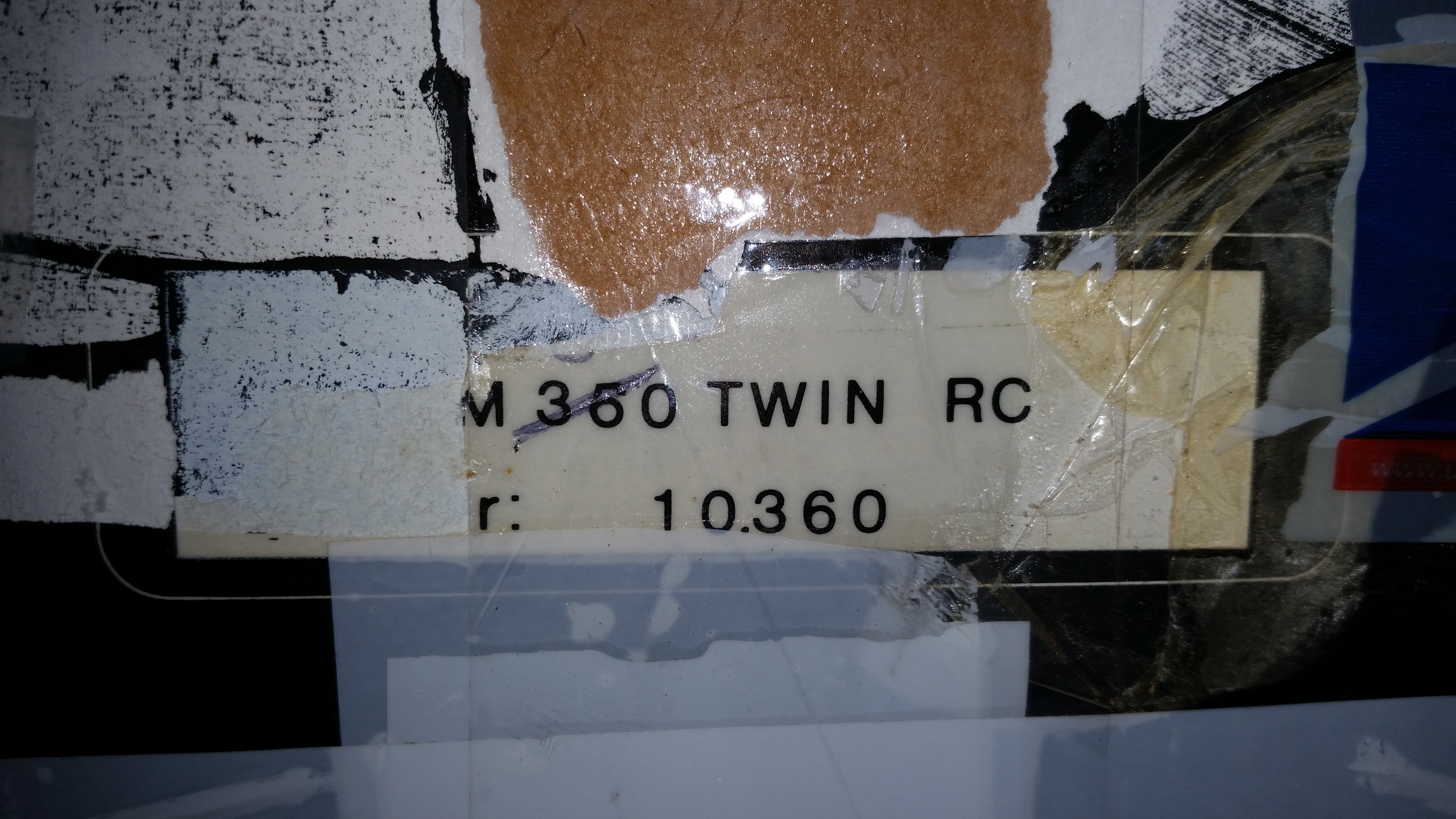

I believe that this engine came out before the 3.60. Just a guess, but the box says 3.50 and each cylinder has a 25 stamped on them which comes out to just over 3.0 cubic inch, so I don't know how they come up with 3.50.
Anyways, I'll probably try a 20X10 for break in. (This engine has obviously never been run.)
But thanks for the info. BTW, what mufflers did you use? I know Jtec and Bisson make mufflers for Moki, but I was wondering if you could manifold the cylinders together and have one canister. http://www.rcuniverse.com/forum/atta...mentid=2168411

That is odd since that 10.360 number is the part number for the 360 twin.
Mine says M180 on one side and 30 on the other which makes it a 360. I wonder if yours was rebuilt at some point with the older Moki 1.50 cylinders?
I am using the Bisson Mufflers, but would prefer a log style cannister with one outlet. DA uses that type of muffler on their 100cc inline twin.

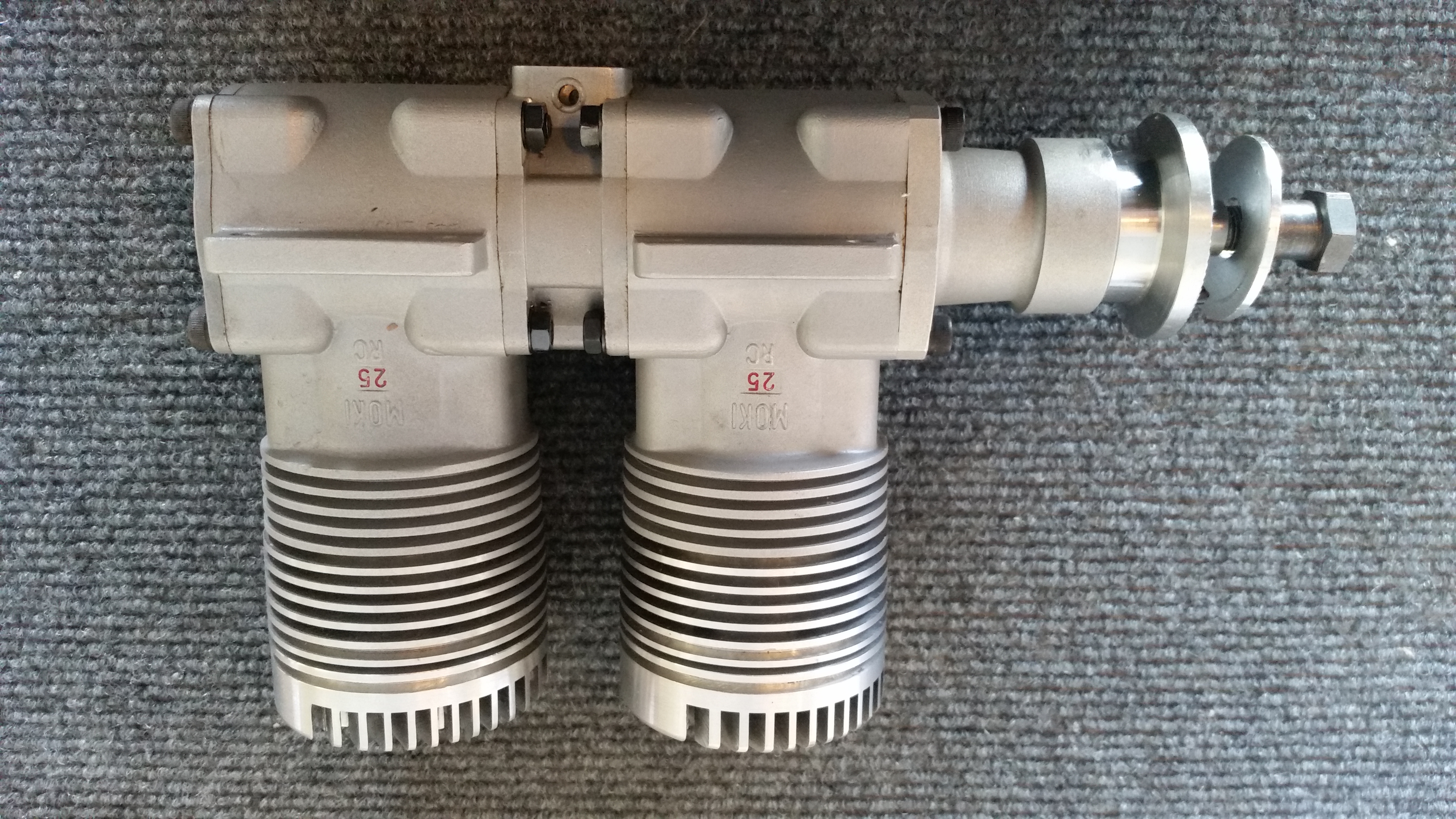

Here's the motor....http://www.rcuniverse.com/forum/atta...mentid=2168412

I'll try this again...http://www.rcuniverse.com/forum/atta...mentid=2168413

Certainly not rebuilt. I would contact the factory and ask. This is important because they had crankshaft upgrades along the way. Early cranks were prone to breaking.
Wear a thick glove when you start it. I find it easiest to back flip against compression. Every once in awhile it will get into an odd cycle where each cylinder is firing in a reverse order from one another. It rocks back and forth only turning a half a turn....very strange looking and sounding
