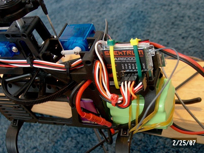

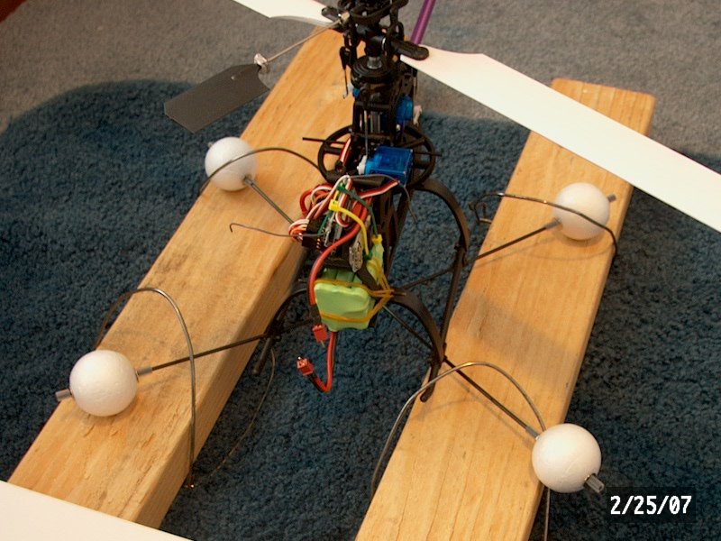

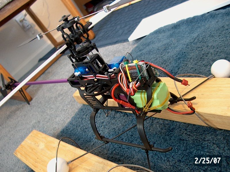

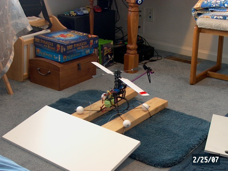

SUCCESS!!!
Check out the pics!
What we have here is a Helimax dynamic test stand. It allows a couple inches of free movement for the aircraft in complete safety and there it is right in the living room, freakin out the wife!
What I learned
My settings were conservative - at full up stick I could barely lift off. Good!
I made lots of adjustments and came up with a new Throttle and Pitch curve that should allow for a tame platform to learn the hover.
I needed more control Cyclic control throw.
The EXP function helps tremendously, compared with the stock radio.
When I get this all dialed in, I will post all the settings. That should really help the next guy to try this. I thought a bunch you had already converted to DX6, but I guess I am one of few (I doubt the first!).
I have now confirmed that the heli is safe enough to try at the large clubhouse, on the smooth flat floor where I can hop and slide around enough to see if the vehicle is ready to hover! I really don't think it will get away from me!! I will conquer the hover is short order!! BOOYAH!!

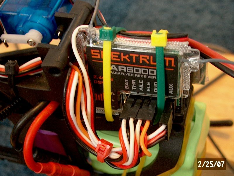

I just got done replacing all the stock servos with HS-55 servos
I had to remove and reinstall the AR6000 receiver to get all the wires neat again.
I then did a static test and it looked so good I decided for a full power test - while holding the model carefully in one hand!!!
I then used the other hand to check the left stick response - hmmm, not enough revs on liftoff...
I shut down and upped the throttle curve and tried again - NICE!!!
I then set the left stick at about 70% up and checked out the right stick. Hmmm, she needs slight control arm adjustments to correct a serious down elevator and right cyclic pull - but I was able to compensate with the stick and I believe I got her into a nice hover while secured in my hand.
Tomorrow I will do the final control arm tweaks and then see if the large Club house is available for some hopping and sliding runs
If it feels right and I have the confidence I'll attempt a hover, but not until I am confident with the sliding and hopping...

I went through another couple dry runs and made final tweaks on the mechanicals. I then put the icing on the cake with Sub-Trims to get the control arms exactly level at zero collective.
I then put a few turns here and there on the control rods so the swashplate appears perfectly flat and level at Zero Collective, and the sticks are dead-centered.
Whew!
Yeah I have the stock servos here and they appear similar but I have heard several reports on other boards that say when you are hovering, then apply some cyclic, the slop in the servos causes a sudden loss of altitude that must be fought with more throttle but then you could go shooting up so... It sounded like something easy to avoid so I splurged...
I will probably splurge next on a GY401 but more research is needed.
For now, its off to the clubhouse for our first sliding and hopping exercises!
When I'm done, I'll post the 'recipe' for programming the DX6 for use with the Axe.
Whew!

Success!!
Almost total and massive success!
I did actually accomplish a couple very short 1 - 2 second hovers at about a foot off the floor, but it was unsustainable.
Sliding around the floor was fun and controllable. Hopping had its problems, as with the hover.
What I learned on this run was that my rotor speed is too high. I did see the model liftoff at a little more than half up stick.
So I went into program mode and dropped the throttle a bit to 60% at half-stick. I also notched up collective to 65%. I kept the CCPM setting at 40% (CP2 = CP3 = CP6 = 40%). If I set this higher, it appears I have too much total collective throw for a nOOB to learn on, so this seems fine for now. Example: With this set to 60%, it appears that the swashplate has total free reign over its entire up/down travel range - full positive to full negative collective. You could strip a servo gear if you set this higher, I would think.
So after those tweaks, I tried again and it was only a little better. I still think the rotor may have too much spin for a Normal Flight Mode Hover.
Another minor issue: I was wanting maximum stability so I had added flybar weights (from a T-rex). I was fighting that flybar way too much! It was a good learning experience though. I still want to see what they can do, so instead of removing them I just adjusted them all the way in. Should be fun to see what they do there.
And the final minor issue - I was fighting the flybar because I was fighting - - Wind!! Wind?!?! From where? I was indoors!! Ahhh sooo... the air conditioning was on, and there was enough airflow in my test area to mess up my ground effect and cause signifigant drifting away from the test area. Arg!!! [:@]
In fact, if not for the flybar, I am pretty sure I could have held position, even in the hover! But, too risky with that stupid indoor breeze... sigh...
In any case, she did not exhibit any naughty behavior at all. No shooting off in random directions, and rock solid servo action. Good solid control throughout the whole exercise.
I am confident I can get into a stable hover after a few radio tweaks. Other than adjusting the flybar weights, I see nothing more to do with the mechanics. She runs smooth and *wants* to fly!
