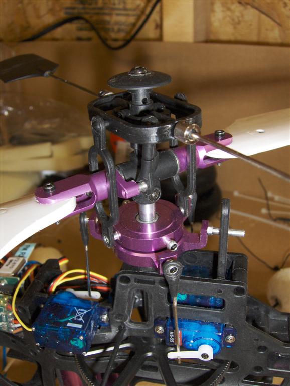

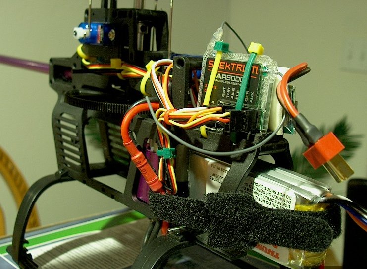

Ok before I go and crash here, for posterity, are pics of my current Axe CP mods.
AR6000 receiver, HS-55's (newbies note: swashplate should be level when all servo arms are at the '90 degree' postions as shown. This condition should be at the point where collective pitch equals Zero or "neutral pitch". The Radio can acheive this condition in three ways: Normal Mode, with left stick at about 1/3 up. Stunt mode, at mid-stick EXACTLY, and in Throttle Hold mode, at mid-stick EXACTLY. Experts confirm?) and TP 1320 LiPo Pack with Ultra Dean's connectors all around.
Also note the extra time spent on the neat routing of the wires. Every wire can be traced visually - no rats nests or tangles.
And the Velcro Straps not only are quick and easy and secure the battery pack very well, but they also provide a cushioned insulator between the motor and the battery pack.
Also, a dab of hot glue around the top receiver wire helps protect it because the canopy bumps it all the time.
Also I see a a pic where a servo is not in its 90-dgree position - it got nudged in handling. [:@]
And another plug for DSM - I really heartily recommend Spektrum DX6 or DX7 or Futaba 6EX radio for this and all models! Its really a good investment - the receiver can be carried over to another model (when the time comes), and already you can have up to 10 models (or more I think) going from one radio. The cost averages down when you get more models hooked up
The benefits are HUGE! In particular you can program the radio to make it easier to hover than stock - a great plus for nOOBs. Then you can tweak up the agility as you get better!
Also, FREEDOM from interference and channel worries!!! JUST FLY!!!
No I'm not a sales guy nor have any stock in Spektrum or DSM but I really think its the BEST solution for RC radio gear.
When considering the cost, consider the money lost from crashes because the stock radio is a bit squirrley (i.e. really its set up for a more advanced pilot and its hard wired that way) and you'll find its a good cheap insurance policy as well.
Steppin off the soapbox now!!

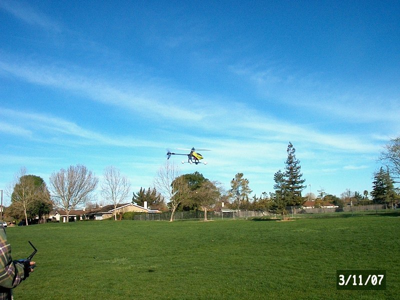

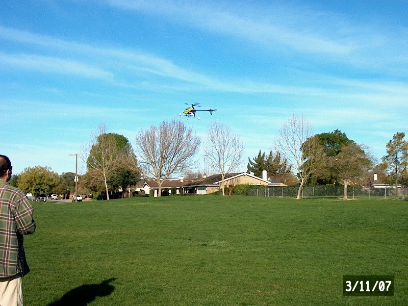

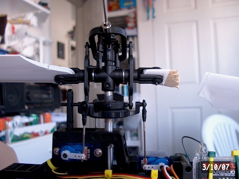

PERFECT FLYING DAY,
until...
Yep, I guess crashes are inevitable. But they can be minimized!
I was just launching after I put in my 3rd pack fresh. My tail was quite a bit off she spun around a bit. I tried to compensate and almost did but I got into an overcorrection back-and-forth cycle on the cyclic.
Probably, I should have hit throttle but that probably would have made a bad situation worse - bolting up without being in control crossed my mind as being a bad thing.
As it was, I came down on the thick wet grass and broke just one main rotor blade. No other damage!!
Woo hoo!! I still have a great feeling about this run!! It was a perfect day, DEAD CALM and I mean DEAD CALM!!! And a bit cool too - PERFECT!!
The first two packs were beautiful! I was doing huge, sweeping circles out to a 100' out, got tons of altitude (up to maybe a 80 feet!), got LOTS of speed runs!! It was FREAKING GREAT!!!
Got LOTS of pretty passes right in front of me, too! So totally cool! Lots of pretty, totally controlled and coordinated turns!
So hey!! I broke my first rotor blade but man, I have made HUGE progress!! I was having a super ultra BLAST!!!
I checked carefully for any other damage - can't find any. I will happily pick up another set of blades today!

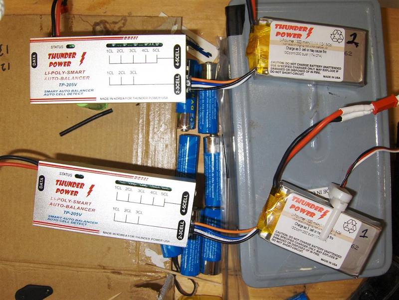

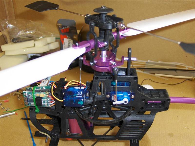

ORIGINAL: markind
That velcro battery strap thing is a pretty good idea. Currently, I am using the Heli-Max supplied "hitech" rubberband mounting option.
However, I did use some double stick servo tape to tape a small piece of foam to one edge of each lipo. I did this in attempt to keep the heat from the motor off my lipo packs. I also practiced nose in hovering for 3 more packs today. I must say I am getting better and not intimidated by it at all anymore. I can almost do a complete slooow piroete while keep the heli totally stable and in the "box", as Radd would say.
As far at the quality of the Axe, I am impressed. For less than $200 I was able to get a CP heli to learn on that flies well, is inexpensive to fix, and in my opion is very stable right out of the box. However, I already have my eye on a T-Rex 450 down at my LHS and will more than likely pick one up in the very near future. Because of this I am going to leave my Axe stock and save my pennies for the future T-Rex.
As for the T-Rex being expensive, I don't really agree with that. It is all realative. A new Traxxas Revo or Losi Muggy RC monster truck will set you back over $500 before you purchase any support equipment. And I have enough money tied up in my Losi XXX-T/Mamba Max 5700/ 3s lipo to buy a very nicely optioned T-Rex 450. As I add it up, one could almost get into a 600 for the money I have in that truck. [&:]
Keep up the good work everyone.
Here is a pic of my batteries with the foam insulation attached. And one pic of my Axe with my other RC toys.

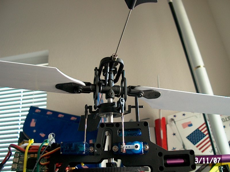

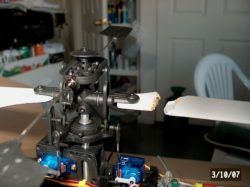

Hey guys (yep, I don't think there are any gals around here...),
I got my Axe ready for testing again!
BUT, I went and installed the Flat Bottom main rotor blades from the Blade CP. My LHS doesn't carry Helimax in stock (but they offered to order anything I needed). I removed the top plastic shim, and they went in pretty well.
The hole is a bit bigger than the screw though. My thought was to get the bit from the shim that actually goes in the hole, then it will be a snug fit top and bottom.
Any other tips or dangers to be aware of when going to Blade CP main rotor blades?

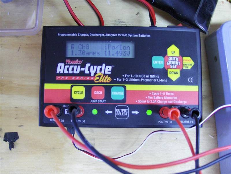

pics of cnc and pics of lipo setup. note just over 1hr to charge 2 packs at same time.
ps i do have all the cnc parts on order 3 more to go just waiting for them.

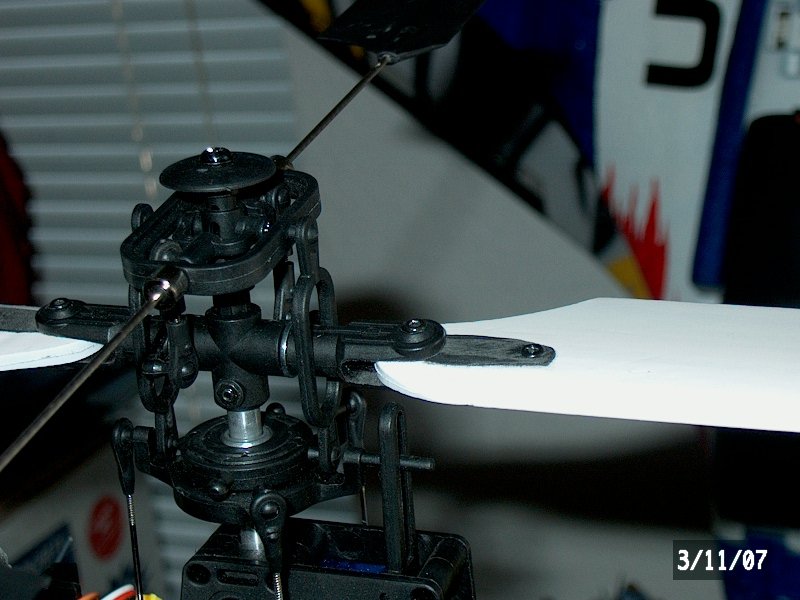

That's interesting - I ended keeping both the top and bottom bits of those BCP shims.
They needed sanding down to fit, but fit good and allow some swing just like the stock setup!
I think she is ready to try to hover again.
It was VERY tedious getting the blade tracking correct - but I finally got it pretty close. I see no obvious bad vibration in the system at any power / pitch level. whew!! Bench testing - PASS!
What I did was modfiy the plastic grippers that come with the Blade CP blades. They needed sanding down and trimming quite a bit to fit well in the Axe blade grips. They are needed because they have a plastic ferule that sizes down the big hole and fits the Axe blade screw perfectly, BUT they are too thick to fit in the Axe grips along with the blade.
Also, I had to sand down the inside of the Axe grips just a bit.
Getting the tracking close was so tedious I was thinking, oh rats, do I gotta pull everything and go through that tedious blade balancing procedure?
But I was only going to do that if I ended up with an undesirable vibration and once the tracking was dialed in she sings again in perfect tune! At all levels of pitch and throttle, everything looks pretty good.
I'll fly her again tomorrow at work - VERY timidly!!! Basically, she's an experimental aircraft all over again - can't take anything for granted until she's proven herself again.
