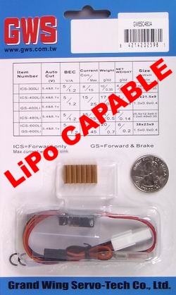

I recently took the leap and did the HH upgrade to my Axe CP with the GY-240 and using the ElectriFly C-12 ESC for the tail. Have not yet, but am looking forward to, dumping the 3-in-1 board for a "GWS ICS-480 ESC".

Alien,
I recently smashed my 240 and am back to using the original setup. Temporarily short of funding (ie: the wife won't turn loose of enough to replace the 240 until I finish the deck in the back yard....). I be in better shape to give you a response in about three weeks, so hope no offense if I don't get back to you until then ( if somebody else jumps in earlier, I will surely understand if you go for it). We are talking the GWS ICS-480? And I'm still using the brushed motor.
Joined: Feb 2007
Posts: 359
From: miami,
FL
Yup.... Actually the one I have is the next step up (I think). Mines is the ICS-480Li (LiPo capable).
ICS-480Li Specifications:
Dimensions: 25.5 x 12.5 x 9.0 mm; 1.00 x 0.49 x 0.35 inches
Weight: 14g (0.49 oz) with wires; 4g (0.14 oz) without wires
Heat Sink Size: 12 x 21 x 6 mm; 0.47 x 0.83 x 0.24 inches
Heat Sink weight: 2g (0.07 oz)
Frequency: 2.8 KHz
Auto Cutoff: 5.4v for 2S; 8.1v for 3S
BEC: 5V at 1.2 Amp max (use dedicated receiver battery if more than 1.2 Amp is needed)
Reset: throttle lowest
Current: 15A continuous; 25A Max.
Battery: 2S or 3S Lithium Packs (7.4v, 11.1v)
Battery Connector: Mini Tamiya
Connector: Universal for Futaba, Hitec, Airtronics-Z, Multiplex
