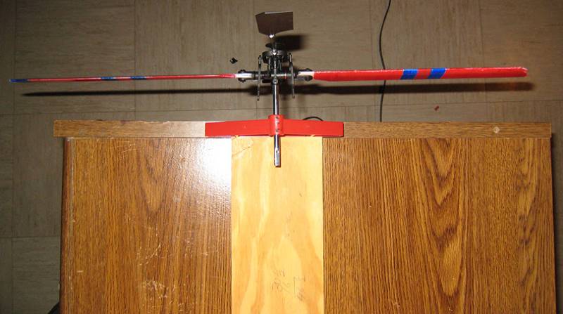

Home. Cannot find source of slight vibration. Balanced blades again, measured flybar to verify it was centered, checked flybar carrier, mainshaft, slide block mounting. NO vibration with the blades off, slight with them on. Even tried pieces of tape on either blade. With the vibration nearly gone, I went outside, began to fly when it again rotated quickly around 3 times + and I couldn't stop it. I think it went clockwise, which means the tailrotor was at full power. (again, it wanted to go left, so I added a little right) Lost it. Throttle down, flip off idle-up, watch dead chicken dance. Really pissed me off, so I put it up for a while. WHAT HAPPENED TO MY SMOOTH FLYING HELI? ARGH...

About the bad vibes. Measuring doesn't always work. Here's my method. First I balance the flybar then I install and balance the blades. Works every time.

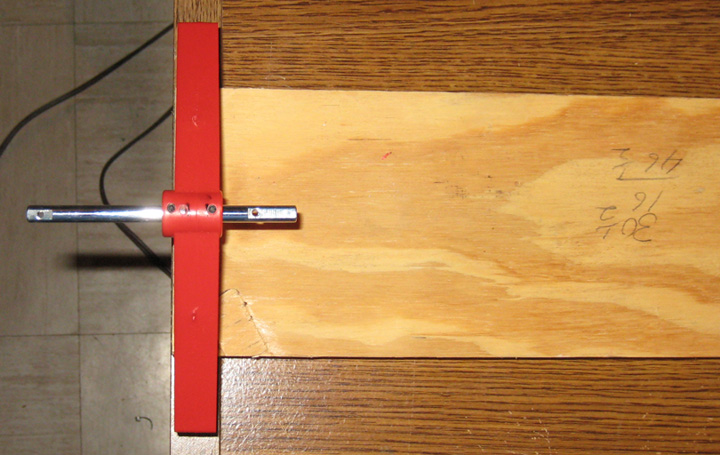

Tore everything down and rebuilt from the Main gear on up. Found the feathing spindle had a very slight bend right at the tip. This was causing my tracking and vibration problems. The cause of the crash was the tailmotor needs replacing. It wasn't completely dead, but it definitely would not spool up to full speed. I have a spare, but it has a loose connection where the solder and wires connect. This holds the springs and burshes inside the motor. When I push on the wires, the motor increases in rpm. Somebody here has mentioned glueing the end of the motor to hold the brushes in place. The glue is drying as I type. I don't quite have the nerve to try a super cheap replacement yet, let alone upgrade to brushless and gyro. $25 [:'(]
