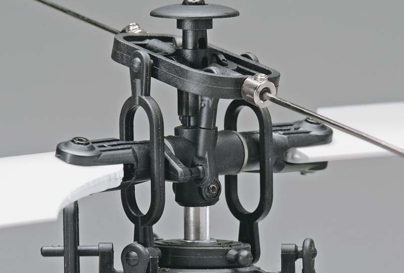

[:@]Went down again and had to replace blades, the sliding black, and center hub. Just tried to go for an evening flight and she won't go up. I put her at full throttle and still not lift. The throttle trim's at 65% which is where I normally keep her. What could be wrong? I checked my gyro and all the arms, etc. everything's responding pretty cool.
Thanks for any help
Old 08-13-2007 | 12:11 AM
Heliko's Avatar
Joined: Jan 2007
Posts: 591
From: Colorado Springs, CO
Default RE: Full Throttle-No Flight
You may have inadvertantly flipped the grips. The ball links on the grips should be on the same side as the trailing edge of the blade.

I'm good there. I thought that too. I'm lost on this one. What else might it be?
Old 08-13-2007 | 10:03 AM
Joined: Jun 2007
Posts: 738
From: covington, GA
Rotor spins but it won't lift off or the rotor won't spin? If the motor isn't turning check to make sure throttle at 0 before you start and that idle up is off. If it won't fly but is spinning up to full throttle then obviously you have a pitch problem that is keeping the heli from making enough lift to fly. Did you try to adjust tracking or something of that nature? A little wierd if all you did was replace parts, then you shouldn't be out of pitch range. Did you put the blades on correctly and not backwards? When viewed from above the rotor spins clockwise.

DK,
Are you SURE about the blade grips? Double check. Don't get pissed if I get too elementry here, just to be sure. Leading edge is the thick part, trailing edge is th thin part. Holding the bird straight out in front of you, the leading should be facing you on the right, the trailing edge should be facing you on the left. The grip on the right should have the ball joint away from you, the grip on the left should have the ball towards you. if you move the flybar, the pitch should change on both blades. If that works, unplug one of the main motor leads, turn on the xmittr, connect the flight battery, hold the tail boom steady, work the collective(or is it the cyclic? them technical terms always confuse me) in all four axies (forward, right, aftward, left) to make sure you get correct response in all four, then run up the throttle and look for pitch change as throttle increases ( no yaw input, left or right tail).
If you got the blade assembly and the hub correct (with the grips oriented correctly, remember that the picture in the 'Manual' is incorrect), the only thing that comes to mind is: 1) maybe you compressed one or more of the linkages (Plastic ballreciever on metal threads, the ball reciever threads can be forced in or out on the metal rod with enough force. Check blade tracking and response of the rotor disk under load (hold the birg, by the landing struts (or better yet, if you have a test jig use that), out in front of you (with the main motor plugged back in), slowly run the throttle up a little, do the above checks, run the throttle up alittle more and check again, and so on.
If that doesn't help you find the prob, I'm stuck, unless you have damaged the 3-in-1 board.
Oh, by the way: I had a hard landing (didn't seem to do any damage), but I couldn't get her to lift off after. Investigation revealed that the hard bounce had managed to jam the main motor into the main gear. Too much drag from tension, I couldn't get enough power to lift off. Tore her down and repositioned the main motor. Everything was alright after that.

Old 08-13-2007 | 07:15 PM
DKhairho's Avatar
Joined: May 2007
Posts: 135
From: Moreno Valley, CA
Hey Splat. I never get pissed at help. I am about to re-examine the grips and try again. I will get back shortly. I did go off the pic in the manual.
Old 08-13-2007 | 07:54 PM
DKhairho's Avatar
Joined: May 2007
Posts: 135
Silly me. Had the stablizer hub upside down
