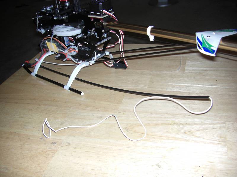

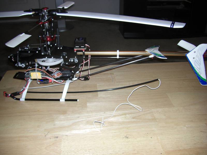

Any suggestions on where I shoute route/ put this extra wire? Thanks

I moved my straw forward a bit then attached the trailing end to the bottom of the vert fin using a length of rubber band for strain relief. On the soild fins you'd have to make a hole for it, though. Not as much straight length as I'd like, but no problems with range so far.

I wrapped the wire around the skids from front to rear then I left just enough to go through the tube and hang out the back a couple inches. So far it's been working great.
