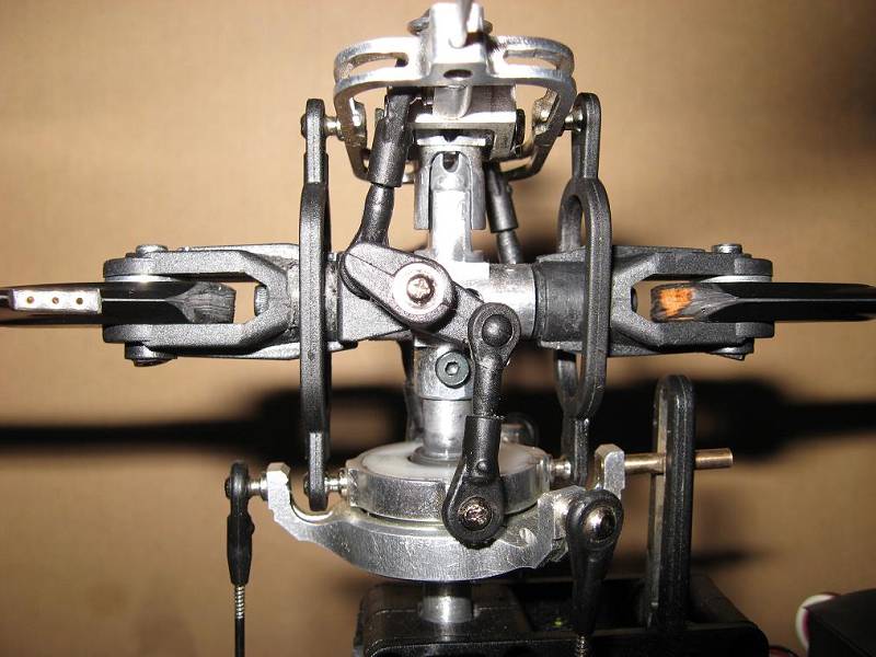

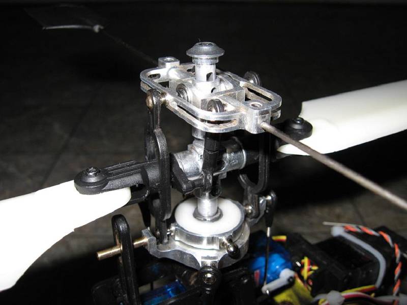

My swashplate on my cpv3 came apart after a lite crash. It seems as thoght I can just push it back together. My queastion is one rings has the connectors to the servo linkage and the other goes to the blade control arms. How do I know how to orient them.

Here's a few pics of the AXE CP with the Bell-Hiller rotorhead, hope this helps.

I had the same problem, 1956. I believe that the two pieces should be a press fit. I cleaned the two parts, then I put a small drop of zap a gap on the top piece, then slid it into the lower part. You don't need to be concerned how to orient it since it is a bearing. Be careful not to get any cement into the the bearing itself.
